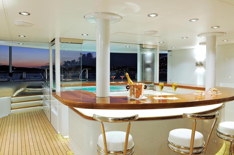

    I can't think of any yachts off hand where the swimming pool and or jacuzzi are fully enclosed.
    I am doing a study to put a 8000 lts pool on the sundeck of an 80m steel motoryacht right now.
    The structural mods are quite something in themselves. There will have to be 4 x 125mm sand filled steel poles all the way down through the boat to the top of frames that are attached to the shell plating. It has also been clearly stated by the Naval Architects and Shipyard that the pool is only for use at anchor or alongside.
    I have worked on other big yachts with Jaccuzis and am yet to see one that can be used when the boat is underway in a seaway.

    I found the boat I was thinking of when I said I had seen larger yachts with indoor pools and it looks like Im mistaken. Heres what I was referring to:
    The stupid dumb Madsummer
    [​IMG]
    Looking through the YF reviews Ive realized the only boats with jacuzzis or pools are the displacement hull types and I think the Manhattan is a planing. Ugh, whatever happened to the expression "Theres a will, theres a way!"
