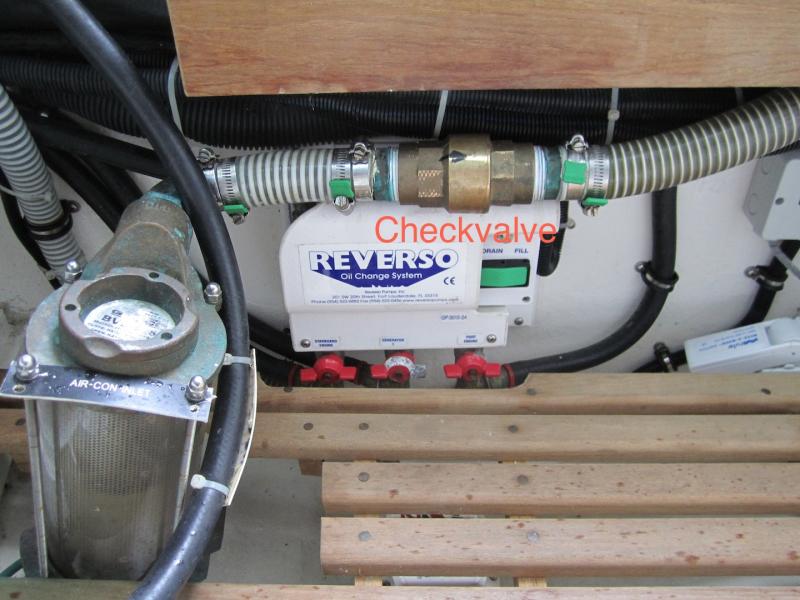

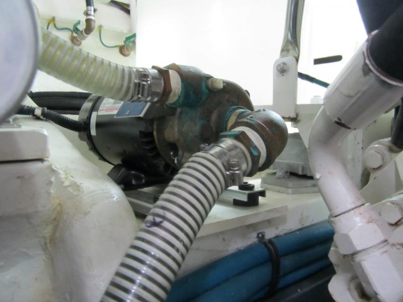

    Thanks all for the advice. I'm hoping the yard will come down and fix it this week as I research the issue with everyone here. I've attached a picture of the check valve and pump. The pump appears to be below the waterline but its close for sure. I'll let everyone know what the solution was once I get it sorted. It seems simple enough but its a boat right?

    Take the hose off of the pump and see if the hose flows water at that height. If it does, yank the check valve out of the system as there is no need for it........

    Will try that. Thank you. Whats the purpose of the check valve in this configuration? Is it so all the water doesn't back out when the system is off (I guess it can't if the pump is below the waterline), does it help with the prime or is it there just to confuse everyone?

    This check valve is the most stupid thing I ve seen in a while! There is no way the pump will self prime!
    I just hope they didn't put it in because the pump is above water line... And I can't believe the yard remove the pump to bench test while ignoring the check valve!
    Not sure have the oil change pump deep in the bilge under the check valve and close to the strainer is very smart idea either...

    No need to pull the hose off, just open the plastic bleeder plug on the wetted end. Then replace the plug with a valve so you can prime it easily in the future.
    And while you are at it remove the check valve. And either **** can it or if you find you really need it at least put it on the discharge side of the pump where it might do some good.

    That check valve has a cracking pressure much higher than that centrifugal pump could hope to draw when it's dry and probably just sufficient when primed. I have modified that type by cutting back the spring in gradual steps until I had just enough to close it when at rest but if someone in the future replaces it they will have to do the same thing all over again.
    If you need to have it, and it looks like you probably do, a far better solution is to install a swing check valve in the line instead, they rely on gravity to close a flap instead of a spring driven plunger and way less cracking pressure. You will still probably have to prime it the first time though.
    That hose used for the line is not the correct type either and should be replaced. That is vacuum hose and not rated for below waterline use, replace it with some good quality wire reinforced hose rated for suction. Black rubber hose will also grow less crud inside compared to the clear vinyl you have now.
