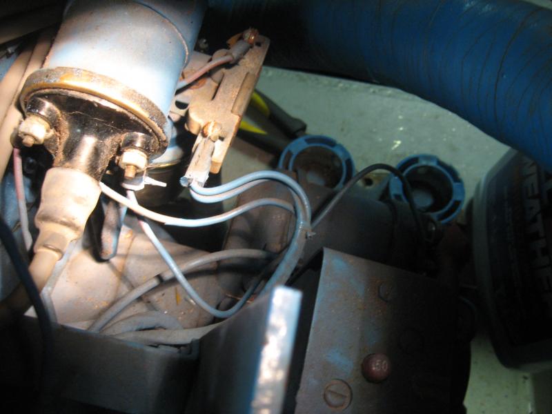

    OK I have twin 1987 "350/454ci" crusaders. Serial #60292. While at the fuel dock the other day the stbd one died, I restarted it and it seemed to feel like it didn't have any power almost like no gas and then died again after a few sec. Got back to the slip on the other Eng and now it won't start.
    First thought was fuel so I opened the main aluminum tank (the port eng continues to run fine on this tank) it has 1/4 tank of fresh and clear gas. I just finished a 260 mile trip about a month ago. I have checked and the vent line clean/clear and open. Took a hand bulb pump and get good fuel from the tank to the canister filter on the eng going through the selector switch and a bulkhead mounted filter. The filter was clean and clear but i replaced it anyway and it was replaced new before the 260 mi cruise here. Pulled the line off the carb and turned over the eng and have good flow whit good streams in the carb. So I don't think its fuel, not i turned to "spark" it does not seem to me that I'm getting spark from the plug wire or the coil to dist. with when i ground them out on the eng. I have the Mallory YL 670AV distributor with what were pretty old points. I changed the cap and rotor as well as the points and here's the odd thing. Still will not start and when I compare the voltage between the good eng and this one, with the keys turned on i get about 11.5 volts from the lead on the dist. going to the coil, and from the coil to the resistor in the pic (both sides of it) and then on down to the starter solenoid vers diff voltages on the good eng. Can anyone help or tell me what the issue could be before i have to call in a mechanic.

  8. Capt Ralph
    12,647
    In your picture is a ballast resistor. it's bad. It happens.
    With a temporary wire lead, bypass the resistor.
    You will crank up and run.
    Order a correct marine ballast resistor for both engines.

  9. garyohv
    garyohv New Member
    Jun 13, 2011
    36
    Florida & Oregon
    Often the resistor is only in the "run" circuit, so the engine will start, but stop when the key is released. But Crusaders often keep the resistor in the circuit, both start and run (seems wrong). He states their is (low) voltage at both sides of the resistor, so it is good. With adequate voltage at the coil (11.5), and the high tension wire not sparking near a ground, it suggests a bad coil, condenser, or points. The low voltage is a connection/key/fuse problem.

    Ok found the problem, I put in a "new" set of points and it turns out they had a little bit of corrosion on them i guess. After i found no spark at the plugs i took a little 200grit sandpaper to the point and just lightly hit them and "Wham" it started right up. timing was off about 6 degrees but now it starts and runs fine ! thanks everyone for all ur help and ideas ! ! ! got to love boating forums !
