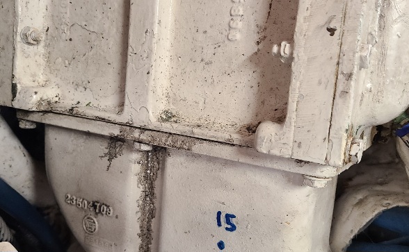

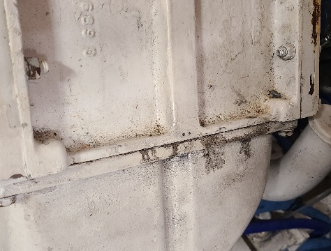

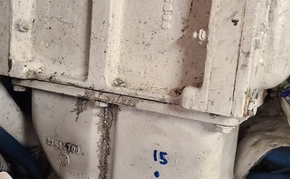

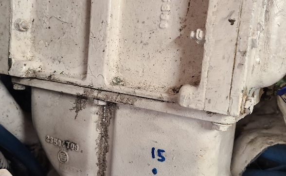

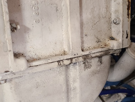

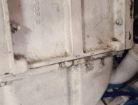

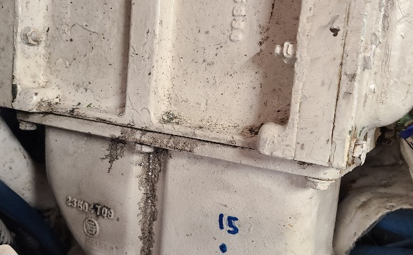

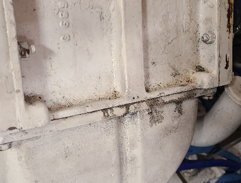

    I've been seeing a lot of oil leaks; oil pan, governor, breather can mount, etc., all over the engine. Plus oil coming out of the intercooler gaskets. I had cleaned the wire screens in the (4) breather cans in the spring.
    I just replaced 2 of the 4 check valves, and rerouted thier drain hoses from the oil pan to a can, to see if it helps.
  6. Capt Ralph
    14,094
    The oil trails in your pictures are typical of normal turbo slobber rather than CC pressures.
