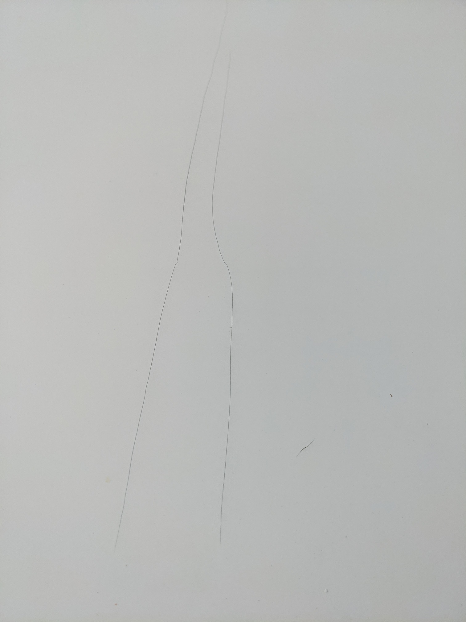

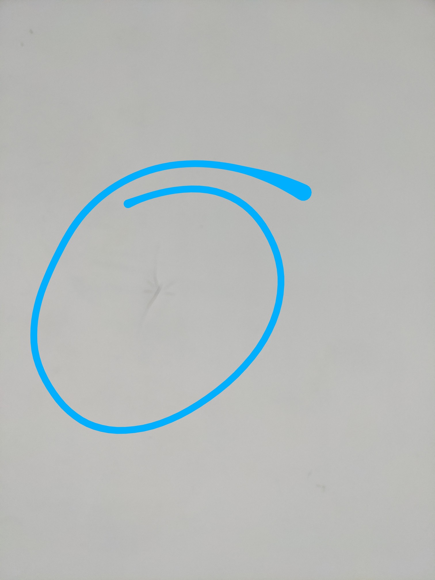

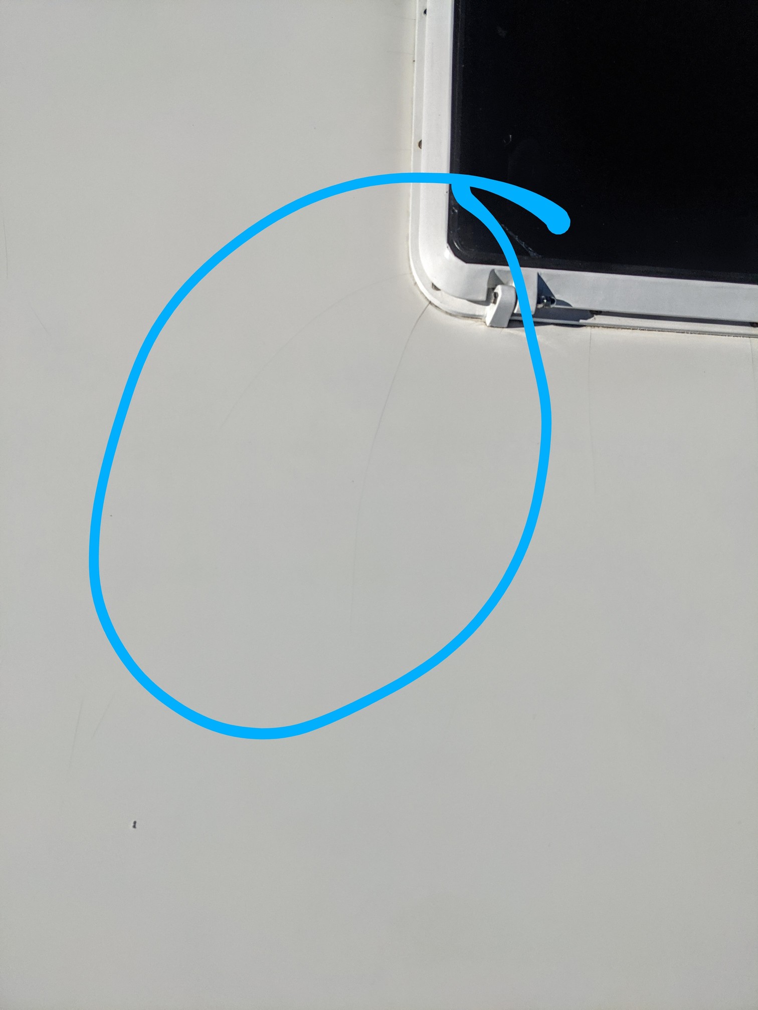

    #3 looks the most serious. The other two NBD. But put a moisture meter to them and push on the deck to see if there's any delam or sponginess. If not that' a DIY project, again depending on your skill set and desire.

    PXL_20210304_141714849~2.jpg PXL_20210304_141724113~2.jpg original_385e839f-768b-4037-969b-f4c7f763f1e9_PXL_20210304_145539872.jpg

    Stress cracks in the gel coat are pretty common across brands and eras. These look like typical gelcoat cracks to me especially if the area feels solid
    the hardest part is to match the gelcoat. Some guys are really good at it, others not so much. Sometimes a repair looks good but then a couple of years later it ages badly.

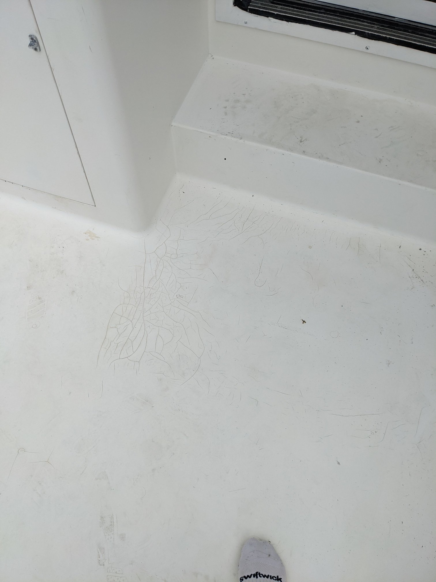

    PXL_20210304_171538541_50.jpg The pics are from a 1990 Post. I do have pics from a couple of Vikings, 90-94. The viking pics are all more like spider webs.
  19. NYCAP123
    11,205
    There you go. And like Pascal pointed out even if you get a good repair it will probably become evident after it ages a couple years. That's why most boats are less concerned with the gelcoat matching and paint over. So if the fiberglass underneath is good and it's not delaminating do the cheapest but smoothest repair you can with the closest color match you can and plan on a paint job. The funniest thing I find is that one of the biggest things that sold people on fiberglass over wood was that it would end all that painting, but soon enough fiberglass boats were being painted and requiring more expensive and finicky paints.
