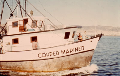

    Copper Hull Sheathing Foils Barnacles
    from that same website, http://www.copper.org/innovations/2003/Nov2003/Cu_hull_sheathing_gg.htm
    ...some history...
    Data collected from the use of copper-nickel alloy hulls on the Copper Mariner and the many vessels that followed established that the alloys are highly effective in preventing biofouling of the hull. (The vessel remained essentially free from fouling for the first 11 years of service, despite the vessel's use in fouling-prone tropical waters.) The copper-nickel hull resulted in lower maintenance costs, lower fuel costs (due to lack of drag), and a net cost saving over the life of the vessel, even when the high cost of fabricating the copper-nickel hull was taken into account.
