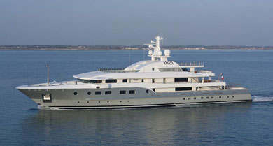

    Far to glorious we speak often regarding the designers. Here is a simple example of a failure design (Author: Tim Heywood), simply because done in 2D. It worked on a side profile, but once in reality and even shot with the unforgivable "tele" one can see that the rubrail doesn't look paralel any more to the water as the bow gets concave.
    No, ooops, its the water that doesn't respect the water line. No, wait, it's both...well it doesn't look right.
    Anyway, bow down is a common shipyard problem; when will designers stop using rullers and sit with a 3D guy for a minute, saying: "wait, let's give to a rubrail and bullwark an angle, just in case....") because, it's ALWAYS a designers fault! One should predict. :D
    (BTW, another "Pelorus"...no, wait, it's "Perfect Prescription"...no, wait, the wing stations are square... it's ....woaaah!)

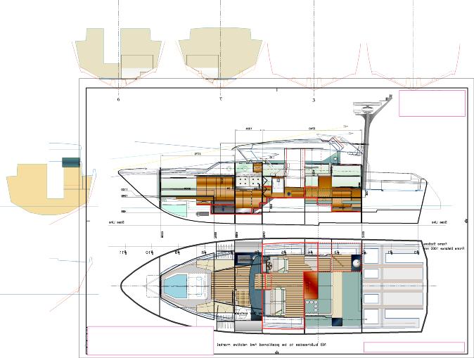

    To make it easier to understand how a design is made, I´ll show you some of what I am doing right now.
    At this stage the hull and deck moulds are already finished from the 3D-files I mentioned and I am doing some interior drawings. As you can see, I do this in 2D, however all three dimensions is present in my drawings too.
    So this is where I can see where the space is and how to use it. This is of course made to scale so I always have the right measurements indicated in the margin when I draw a line.
    There is no big difference in doing like this compared to making it as a full 3D-rendering, with the right program all my lines can snap together and become a volume. (Which I am not interested in...).
    In reality I think the designer is mainly halted by making 3D-renderings and when you see these computer generated "walk-through" interiors, what do you get out of it really? Do you get a true feeling of the volumes?
    No, I think the good thing with Computer Aided Design is that we can make changes very easy compared to paper drawings, we can make several solutions and play around on the screen until it looks good. Then the engineers and carpenters can use some of our files for Computer Aided Manufacturing, a fast and precise method to get all the pieces to fit together.
    This is CAD/CAM. Which is not the same as the 3D-design some Yacht Brokers love to show off with, even if we always did and always will design in three dimensions...:)

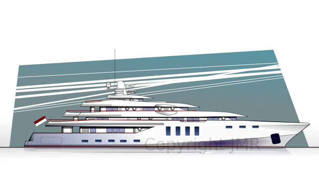

    This is my 2D rendering style done with a free software :)
    There maybe some flaws, since I am not a designer. Next post will show the surface model in 3D. To my experience modelling a yacht in 3D is much difficult than modelling a airplane or submarine, because the later is just a tube :-D
    I did some quick and dirty aircraft modelling for presentation and it took shorter than 1 day to model one aircraft.
    Interpreting a 2D sketch from a designer is not easy. Interpreting my own 2D sketch is easier, since I know what I want 8-D.
    Next post hopely I can show some rough 3D model of the sketch I made and some construction and coordinating work. This will take some time, since I have alot of work todo and I can do it only after 10 hours assisting my customers :-(
