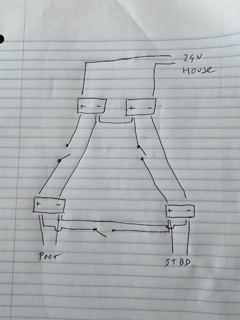

    IMG_2688.jpeg My 53 has a dual voltage system, with 12 volt C series Cummins and 24 volt house system. Reason being that Cummins was charging an extra $1500 per engine to upgrade to 24 v when I repowered…
    so far we ve always been running the gen when off the dock so the house bank gets charged by the battery charger / generator. It works fine but in the future I may add an inverter (with its own bank) and obviously if we loose either gen or the charger we can’t charge the house bank. Not ideal.
    I could look into adding a 24 volt alternator to one of the engines, but I m it sure how it could be mounted…
    so I am wondering if I could add parallel switches between each start battery and each of the two house batteries; that would send 12 volt charging current to each house battery. All batteries are 8 Ds btw.
    any reason that wouldn’t work? Almost looks too simple

    There is just to many isolation concerns that come to my mind in your drawing.

    I wouldn't recommend this. The issues are due to simultaneous serial and parallel connections in this system. Each starting battery being connected (presumably) to a 12v alternator further complicates things and may result in serious damage to the equipment.
    There are many DC-DC converters and chargers available from different manufacturers, e.g. as @DOCKMASTER linked above, to supply the house bank with 24v from either charging source.

    That DC charger would work, wasn’t aware of them.
    We use very little power out of the house bank as all the lights are LEDs otherwise it’s just bilge pumps, heads and the DC water pump.
    converting to 24v is just not worth it. It’s not just alternators and starters but gauges, preheat etc.

    I am considering this Victron DC charger, 12 Vdc input and 24Vdc output. Looks like it will do the job, I ll feed it using a 1-2-off selector switch so I can select which engine to use to charge the 24 v bank in case I loose the gen or charger. It s only 15 amps but we don’t have many loads on the house bank as everything is LED
