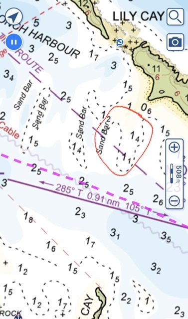

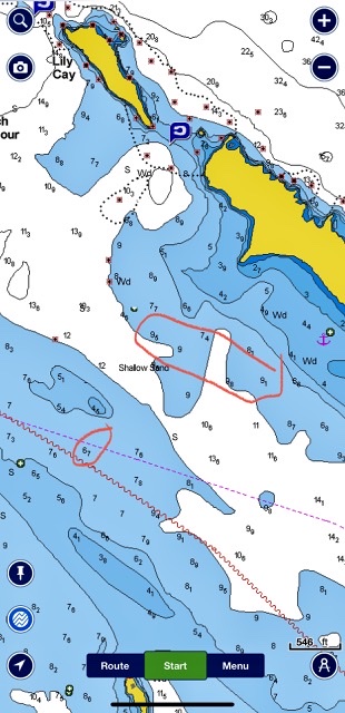

    During this last trip we got together with a friend who has a very nice recent 80 MY and an experienced captain to run it. The boat has a Garmin system, likely 8 years old like the boat.
    as he should the captain upgraded the charts not aware that in the last 3 to 4 years Garmin has been replacing the explorer charts data with its own Navionics data.
    close call coming into Gtown where the new Garmin charts showed deeper water running along the shore of Stocking instead of the deeper dogleg closer to Great Exuma. The first chart below is Garmin Navionics showing 9’ on the straight route vs under 7’ on the dogleg. Second one is the correct Explorer chart showing as low as 1.1 meter...
    This is one of hundreds of errors in the Exumas alone.
    we have Garmin charts on out plotters but there are 3 years old and very accurate. I knew about this and didn’t update them when I got on the boat
    so if you head down to the bahamas, beware. Keep you explorer charts at the help and cross check your routes. You can also install Aquamap on a phone which uses Explorer charts. C-Map also uses Explorer data and can be used in other plotters like Furuno and Simrad

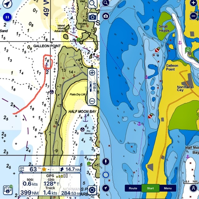

    Here is another example, side by side Navionics and Explorer This is Galleon Point, a very nice anchorage in the Northen Exumas. I ve anchored there many times with the 84 and now the 110 (red line) yet when you look at Navionics you d think there is no way to get there. Better safe than sorry I guess but better accurate than safe :)
    open the picture to see the Navionics side
