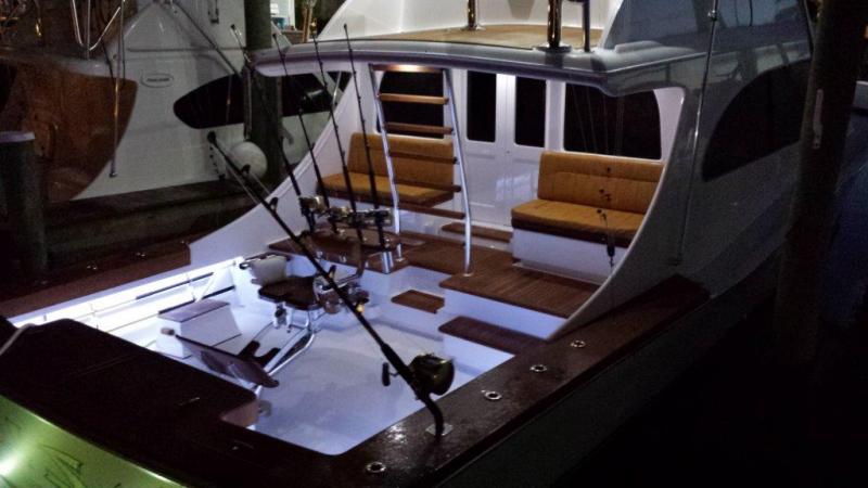

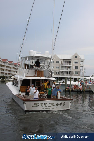

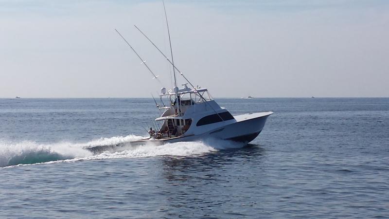

  17. Sushi57
    Sushi57 New Member
    Sep 10, 2013
    6
    Oregon Inlet
    It's your typical Carolina-style offshore fishing boat. See attached pics.
  18. Capt J
    14,435
    Nice boat. It has a transom/aft area look of a Jim smith and a bow more in line with a Carolina Boat.
