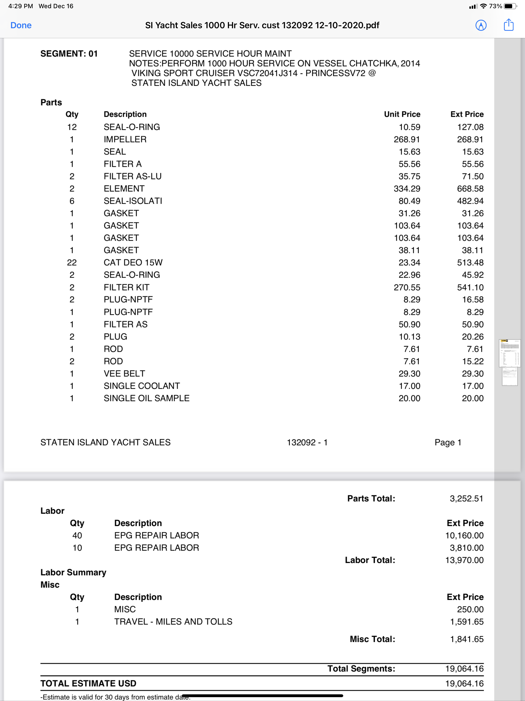

    So I just got a quote from HO Penn for the 1,000hr service on my motors. The quote was $19k per engine! That seems very high. I’ve heard numbers in the mid 20’s to 30k for the service which I believe includes replacing the aftercooler cores. The boat is in Staten Island for the winter. Does anyone know of other companies that might be able to do the service at a more reasonable price? Thanks

    Try getting some details on what they are including, at that price it has to include the AC cores but even with that it seems high unless you have the old styles and additional hardware is needed. How old are the engines?

    I just sent him an email asking about the aftercoolers. I see a charge for 2 elements per engine for 668.58 Not sure if they are the cores. Here is the estimate for 0ne engine. The boat was built in 2013 as a 2014 model.

    C32 AC cores at $334 each?
    That deserves a place as an example of what "wishful thinking" means in the dictionary! :D

    So the SA at the marina thinks that this estimate doesn’t include new aftercooler cores. He’s going to confirm for me. This seems like a ludicrous price.

  7. Pascal
    8,149
    No cores in there. If that’s the case i have no idea what they’re planing on doing for $14k worth of labor per engine.... that’s roughly 140 hours of work!!! 3 weeks.

    Looking at my invoice from 4 years ago, each core was $5200 plus each base $2600, each cover $2500 and tube $1142. I believe that if you have the new style (likely by 2013/2014 you will only need the cores.
    nite that $268 for the impeller is reasonable... here Pantripic charged me $537!!! 4 years ago. Only and last time I used them
    labor per after cooler was $2000
    Your labor quote is outrageous for a 1000 hour service.

    When I looked at the labor I was dumbfounded. They have 50 hours per engine of labor for $14k total. That’s $280 per hour for labor. Can you give me a ballpark on how many hours of labor would be reasonable to perform the service including replacing the aftercoolers?

    As mentioned earlier labor for the aftercooler replacement ran about $2000 per engine. It took two guys about two days to do both engine. The rest of the service is pretty basic, I ll try to dig out the cat service manuals tomorrow but there isn’t much to do from what I remember. Certainly not all the labor quoted!

    So new intercoolers are not included in the quote. They are telling me the aftercoolers don’t need to be replaced. They are revising the quote to remove the travel time and I’ve asked them to check the labor and give me a detailed list of what the service entails on their part
