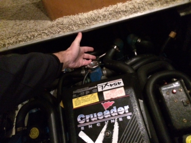

    Went to change the impeller on my Carver 355 Starboard 454 XL and cant seem to find a way to access it. The clearance is just too tight to fit myself in there. Any of you have experience on a 355 changing the impeller on the starboard engine?

    Thanks for the reply. I have done a number of impeller swaps in my past, however the forward part of the engine seems like it is almost impossible to access. The port engine is easy to get to though.

    Always been done through the starboard side hatch in the salon floor. Lift it up and lay on the top of the motor worst case.

    Thanks for the response. Yeah that was what I was afraid of. Very little clearance between the motor and the hatch supports. I will be hanging upside down :). Good experience though in case I have to change one out while away from dock.

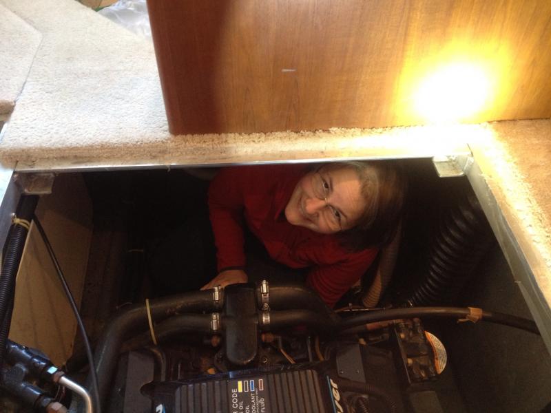

    When it came time to drain the block a couple of weeks ago I noticed the same delima. No way was I going to squeeze myself in that little crack to get in front of the engine block to reach the drain plugs. So I did what every captain thinks about doing. I said "Hey Honey, come here a minute. Do you think you could squeeze in there for me and ..........";). A usual the admiral saved the day.

    Seeing how the admiral is co-owner, she's the obvious choice to fit down in the bilge. It's just not made for a Big guy to squeeze into.

    Here is the admiral hard at work

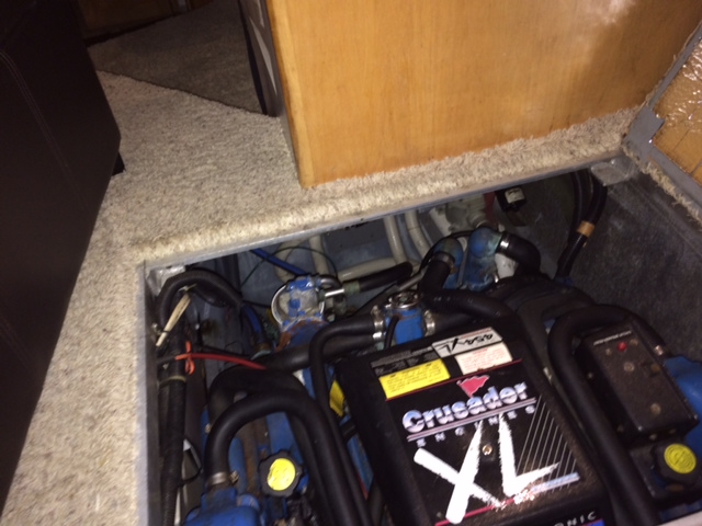

    To paint the picture a little clearer.... this is the only opening I have to access the front of the engine.
