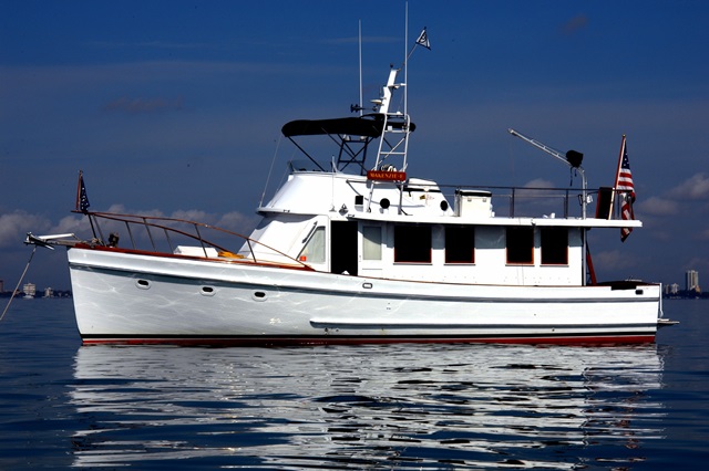

    [​IMG] [​IMG] [​IMG] Digging up an old thread here:
    Mr. Greene did a nice job.
    We put on 15 coats of Epiphanes with 5 more after a few months.
    Then from 2007 to 2013, five maintenance coats per year.
    The sanding and prep was where the hours went on the maintenance coats, hence I had him do 5 instead of 2.
    We did this every May and at the end the varnish was dull and slightly crazed, but I decided to go that route in preparation for the strain summer sun.
    It came to $1,000 per year, all included.
    Sold the boat in 2013.
    Here is recent picture before I sold it:
    [​IMG]
