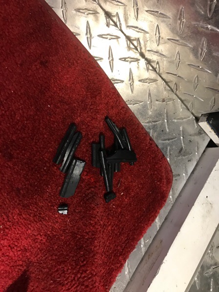

    whenever i replace an impeller i always fish out the pieces, usually at the heat exchanger inlet. Takes just a few minutes. I ASSumed others do the same.
    Long story short... been running an 2009 84 lazzara for about 9 months now. The two onans 27.5 have never run hot but have always been a little louder than they should.
    So today I decided to check the heat exchanger inlets. Stbd only had a couple of pieces coming from the existing impeller which I replaced
    This is what I found in the port heat exchanger inlet. It was all packed in the 1" inlet, not even in the exchanger itself... impeller was intact son I didn't replace it.
    I have no idea how enough water made it thru to keep the coolant and exhaust temp in the green... and we put almost 1000 hours on each genset.
    obviously diesels whether gensets or mains have quite a bit of cooling reserve

    On almost every genset I ve used the pieces end up just downstream from the raw water pump at the heat exchanger inlet. Pull the hose and open the end cap... takes 5 minutes.
    I usually get about a thousand hours on impellers and 2 or 3 years. Hard to prove but I think the key is regular use as it prevents them from takin a set which is what cracks the vanes
