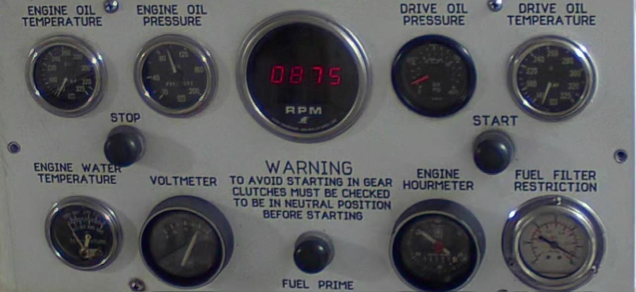

    I just installed ER cameras. to monitor remote panels for Main engines. They came out really well and I can see the gauges perfectly. I also installed a couple cameras to look for leaks, steam, smoke etc. They are clearer than in this picture since this is a phone picture on the monitor. ER Camera.jpg

  9. Lunderic
    Lunderic Member
    Sep 6, 2018
    91
    Oceanside, NY
    ER= Engine Room. I used fairly simple Indoor/Outdoor security cameras to monitor Engine Room and gauges on remote panel. I also have one camera facing cockpit. I plan to add a camera facing forward to the foredeck at some point. I have them attached to a recorder as well for when I'm away from the boat.

  15. Lunderic
    Lunderic Member
    Sep 6, 2018
    91
    Oceanside, NY
    I do have gauges on helm. There are additional gauges on the remote that I don't have on helm (Engine oil temp, Trans oil Temp, Vacuum gauges for filters etc. My main motivation was mainly to look for leaks, steam or smoke. My VDO tachs don't seem to be very accurate so I like to see the digital RPM's. On my very long list of to-do's is to replace Tacho's at the helm. To the OP I used relatively inexpensive Reolink NVR system
