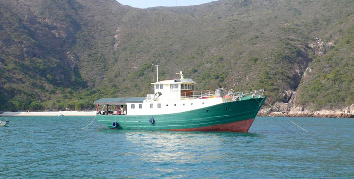

    Out of personal interest I am trying to make the calculations regarding the conversion of a 65' full displacement wooden ex-fishing trawler into a liveable trawler yacht. I am not intended to convert this trawler into a smooth, sleek looking trawler, just liveable and seaworthy enough for coastal cruising and the occasional 500NM passage.
    The dimensions of the boat are LWL 65', B 18', Draft 6'. Displacement is unknown. Hull is build in Yakal and superstructure is ply with glass. Engines are 2 Gardners LXB @ 150 HP.
    What I am trying to find out is how the extension of the existing lower deck superstructure and the addition of an upperdeck pilothouse/ saloon will affect the stability and so the seaworthiness of the boat. As this is a former fishing trawler there should be margin to install additional ballast.
    Thanks for idea's and suggestions.

    Your interests is opening a big can of worms, at the end of the day if you want it done properly, you'll have to visit a Nav Arch.
    What info are you after, stability is a big tree...? Just the CB and Metacenter, which shouldn't be that hard if you have plans...? To find out the weight of the cabin, you may have to get core samples, weigh them, and multiply.

    Thanks Far,
    Basically what I would like to find out is whether this boat will still be sea-worthy after adding an amount of weight high up and increasing the windage at this height. Or what amount of ballast would I have to ad in order to maintain seakeeping characteristics. I can't get drawings of the boat and I can't get the displacement.
    What I can do is calculate the weight that is to be added and calculate the added windage area.
    I found a formula to calculate waterplane and I think there should be a formula to estimate displacement (knowing that it is a full displacement hull)but haven't been able to find it. If I know the displacement I should be able to calculate CB and M.
    I don't own this boat and have no access to it but like to find out whether it would be feasable to convert her into a liveaboard without losing seaworthiness.

    tirekicker11, by the look of things your could really load the vessel up on weight with out much effect on the waterline, but the thing you will have to watch out for if you go ahead with the project is the Moments you will create if you load up the top cabin anymore. Anyways, good luck, Cheers

    As far as I can calculate the boat will sink 1 cm for every 1000 KG added.
    The top cabin will not weigh more than 2000 kg, roughly estimated.
    The top cabin itself won't be top-heavy, most of the added weight will be at around 2 meter above the existing deck (roof of existing superstructure and floor of the to be build cabin).
    It's the windage I am more concerned about.
    If I would extend the existing superstructure all the way aft, remove the existing wheelhouse and build a cabin on top of the existing superstructure and extending all to about 4 meter from stern railing (leave room for a terras), I would (roughly) double the windage of the superstructure and at twice the height from waterline. How this affect the stability I can not calculate. Again (I haven't been below deck but) I am sure there is plenty of room to add 1000 Liter water containers to act as ballast.
    When this boat after conversion was to sit in a marina or on a mooring and do short trips in sheltered waters I'd be pretty confident in it's sea keeping abilities (from a gut feeling) but in order to be confident about this boat making crossings I would want to see it in numbers.
