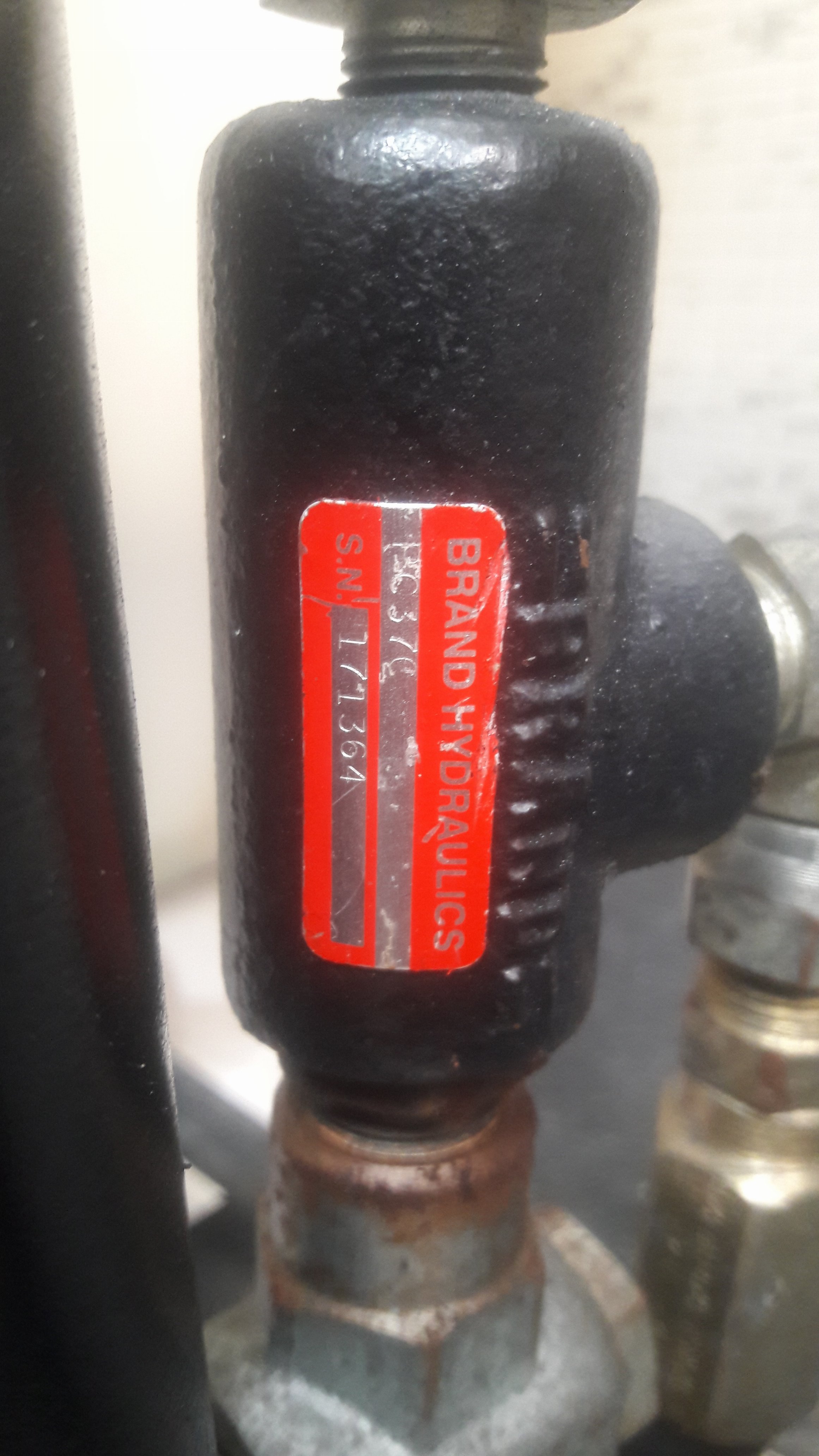

    I am looking for some help identifying the floor lift rams on a Cabo 40 express. One of them is leaking oil badly and I would love to replace all seals. Does anyone know where I may be able to get seal kits. The photo is the only markings on the ram an is on the "T" where the hose connects.

    Call Sam's Marine with your hull number.

    You can find Brand Hydraulics distributors here

    Thanks for the info. They had exactly what I needed.
