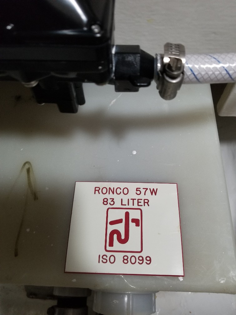

    Holding tank pic on a 40 FB. Looks like 22 gallons after conversion from liters.
    Oversize pic removed.

    Unfortunately from the picture I cannot tell anything. My friends 2007 40 Cabo has the same holding tank as I do.

    If you click on the pic it is then in proper resolution. It just has a placard showing the size being 83 liters.

    Ok see that now thanks. I don't know what to say. Any possibility this boat was built for European standards if they may differ. Will also share that when the wife and I are in the Bahamas we get about 3 days before having to empty. Maybe we are full of it not sure.

    My boat for Euro market? No. I am second owner. Original owner ordered boat new with Drew at SJYS and took delivery in NJ. All the 40's I have seen have 95 gal water tank and 22 gal holding tank.
