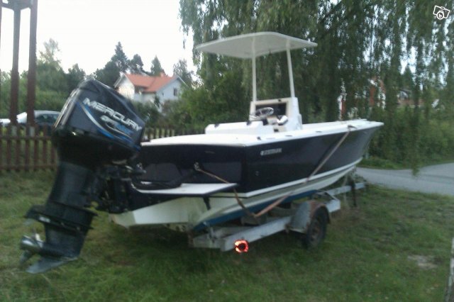

    If I recall correctly, there may have been some Bertram 20 hulls built for outboard power. An outboard retrofit will likely require a bracket mount, or a clever platform/hull extension. Anything would be an improvement over I/O.
  8. AMG
    5,378
    There was one for sale here a couple of years ago. With a GRP bracket and an Optimax 225 hp...

    That's a nice looking rig. Sure would be cheaper to buy one than to "build" one.
