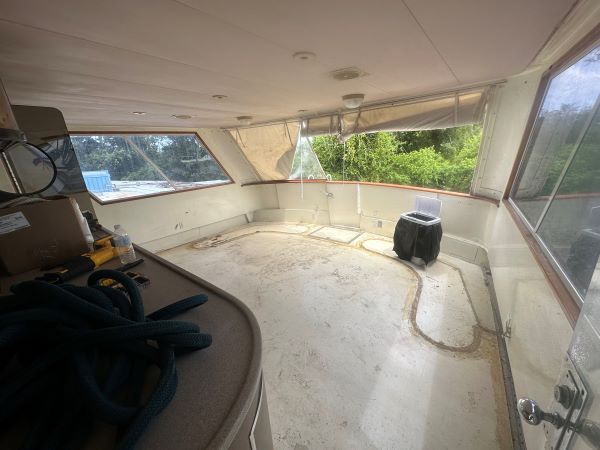

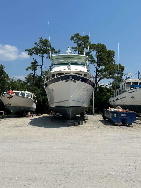

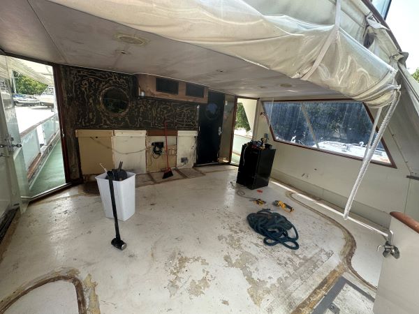

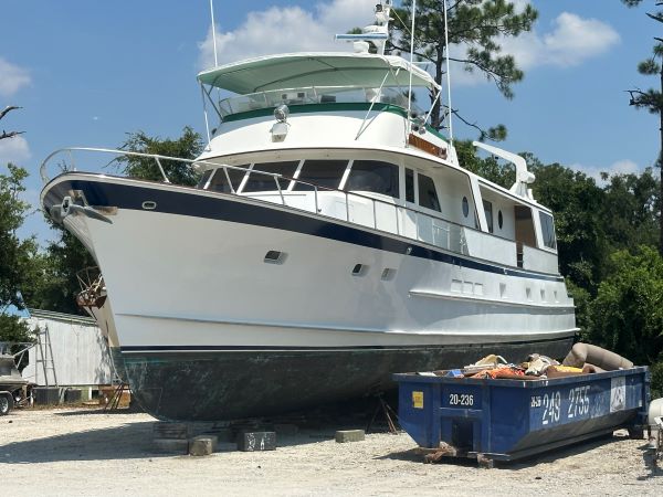

    Figured I would start a new thread to highlight progress on our refit of the 1973 Antilles. Just purchased the boat about a month ago down in FL. She is on the hard at Miller Marine getting a bunch of work done, and while she is there, I am making trips down to tackle a handful of tasks before she makes the journey north to CT.
    List of work being done this month:
    1. Stabilizer removal
    2. Bottom paint and new zincs
    3. New shaft seals
    4. New batteries/32v charger repair
    5. Paint boot stripe
    6. Paint Sheer Strip
    7. Paint Flybridge stripe
    8. Rename
    9. Remove and replace hydraulic steering cylinders
    10. Demo aft deck
    11. Demo Main Salon
    12. Replace Toilets
    13. New Exterior cushions
    14. New Bimini

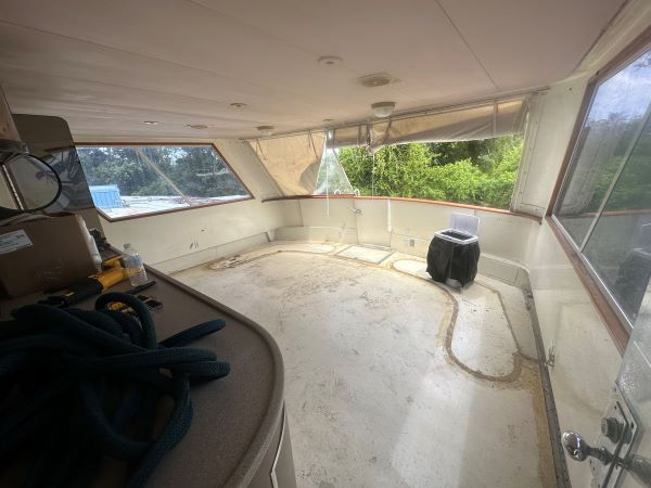

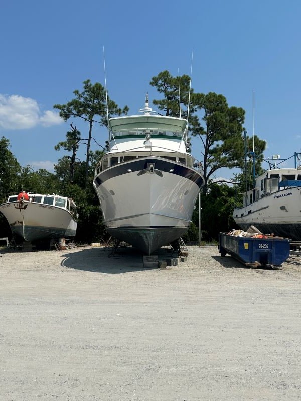

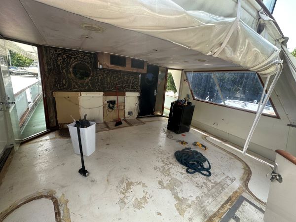

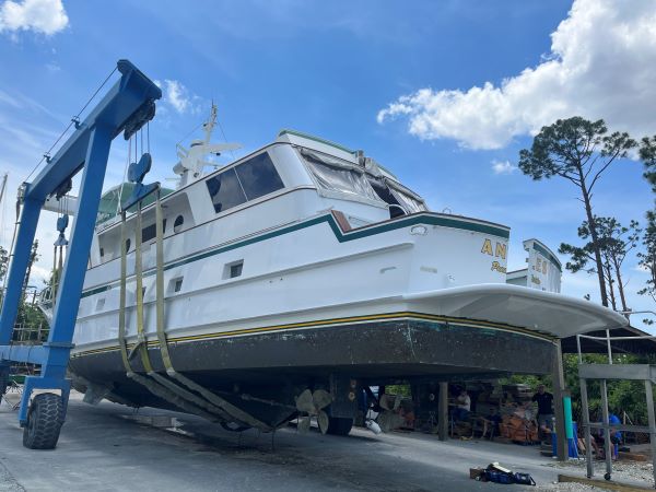

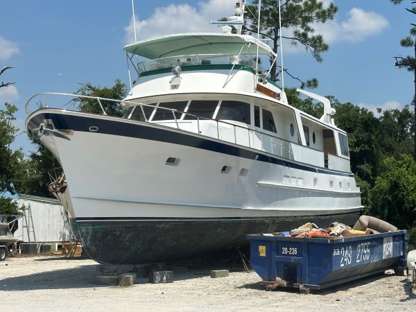

    Here are some photos of progress to date: note - 2 days of work by yours truly and I've already filled a 20 yard dumpster just cleaning out the lazarette, flybridge, bow locker, and all the furniture and demo debris from the aft deck... Will update with more photos in a few weeks when the list has more items checked off.

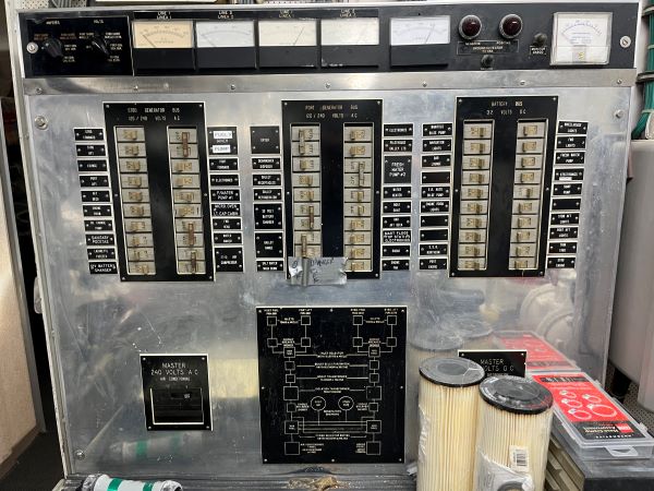

    Ok, so maybe a dumb question, but If I change out alternators, convert the starters, add in some 12volt batteries, new cabling in the ER, add a 24v panel to run these systems and any "new renovations" through, don't I still need to maintain the 8 volt batteries in the stern to keep all of the 32v items running? The refit is going to take a couple years, so I will have areas coming online with 12v/24v, but original rooms still on 32v. Elec Panel.jpg
    Here is the panel
