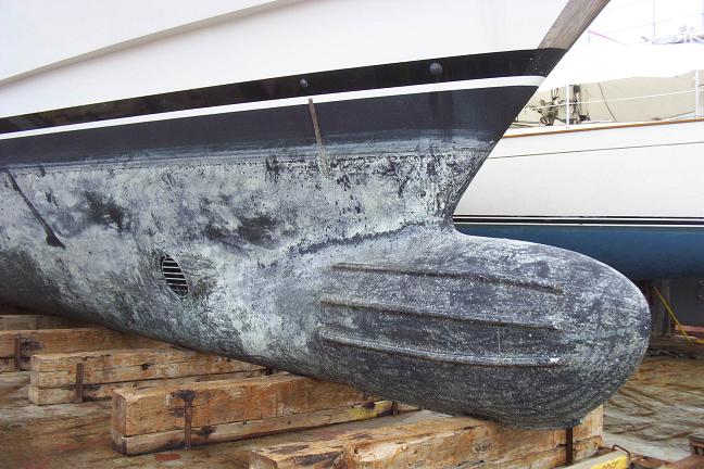

    Take a look at this bulbous bow from a Benetti. It has what looks like strakes running along it. Wouldn't this prevent the water from riding up and over the bulb? Or is it the opposite, where the water gets "trapped" on top and can't run directly off?
    Capt Tom
  10. Yacht News
    25,448
    I'm not sure but those might very well be formed there on the bulb to help with the channeling of the water around the bulb...again hydrodynamics.....On the new Amevi she has thos same lines on her bulb...Sacrifical Anodes?...but so far up though?
  11. K1W1
    7,392
    I think you will find these are to reduce the amount of damage done to the coating on the bulb by the Anchor Chains.

  14. Francois
    Francois New Member
    Aug 19, 2006
    93
    Durban.South Africa
    You guys are the best.I have learnt so much from you and thanks for the links.
    Nice clear picture there Capt Tom.It shows the bulb very well.Thanks.
