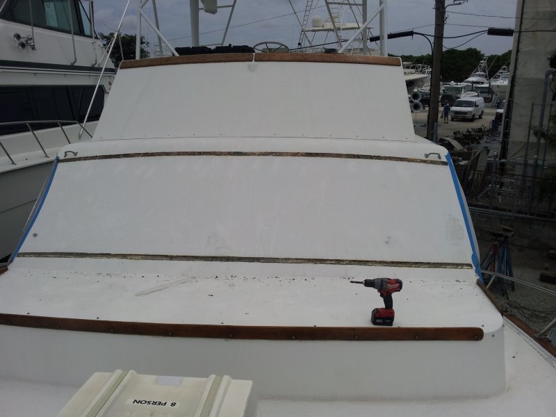

    Has anybody removed the teak brows from their older Post?

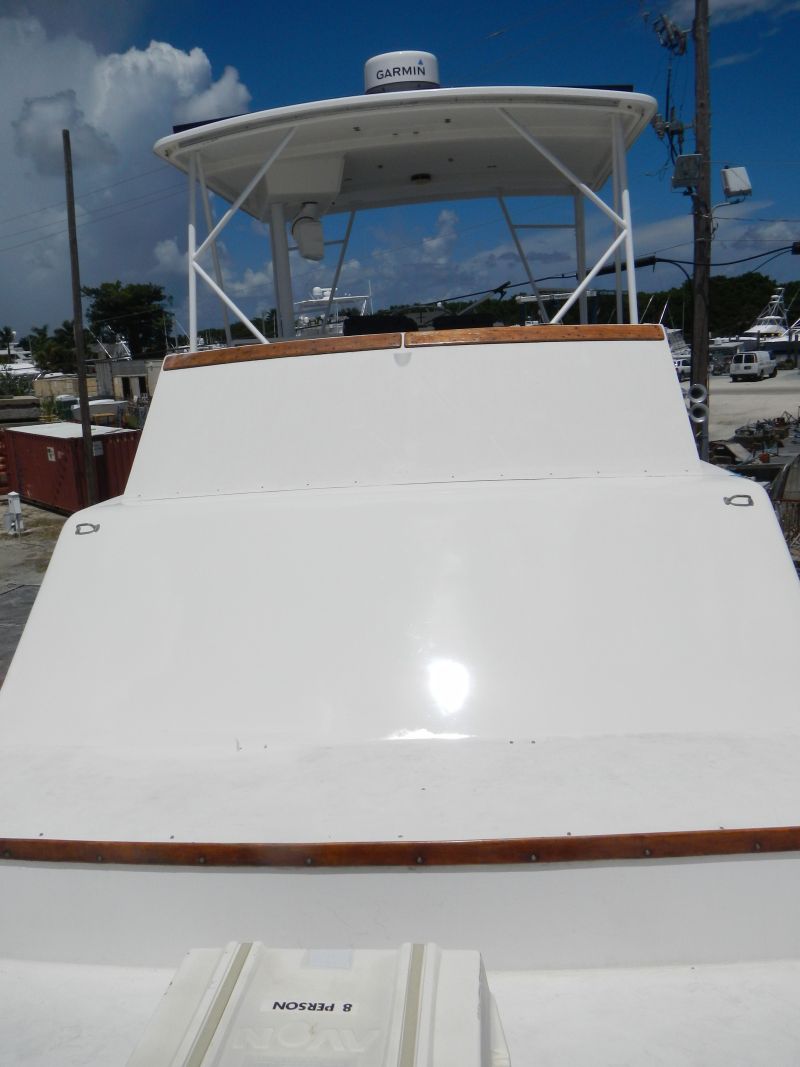

    I removed the one on the front window
  3. P46-Curaçao
    P46-Curaçao Senior Member
    Mar 8, 2013
    734
    Much better now
  4. RT46
    RT46 Senior Member
    Feb 22, 2011
    1,058
    I agree it looks much better.
    what was involved in removing the brows?
    are they just screwed in?
    is there some kind of adhesive?
    was there a color difference in the gelcoat?
  5. P46-Curaçao
    Mar 8, 2013
    734
    Yes, just screwed in, I found no adhesive, just some sealer, took me half an hour to remove, but be prepared to re spray the whole section.

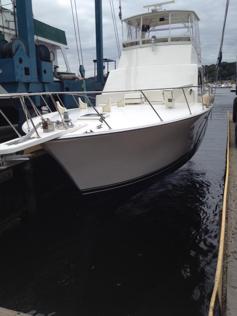

    Beau, I do have the original side hand rails. Enclosed is a pic with the beautiful Bodacious in the background. MW Whit 1 I did replace all 22 bases with stainless steel versions. They covered all unused holes, note some holes did need to be re-drilled. The original holes were drilled slightly bigger and filled with West system 6-10, then I used 5200 to bed the new bases. Just an FYI for you guys who need to replace their bases, they are not through bolted at least on my 1986 46, I do hope you will find the same on your own boats, which makes the job much easier. The end cap which is located midship on port and starboard sides is basically a fitting that is used in canvas shops when they make top frames. I will report back with the angle degree of the bases, I think I may have saved the package so to help identify what I had used, if my memory serves me correctly there may have been a few that were a different angle.

    Your Post is the one on the left side?
  18. ruby
    ruby Member
    Apr 22, 2012
    230
    Long Island
    P46, yes mine is on the left side, the one on the right is Beau's 50'
  19. P46-Curaçao
    Mar 8, 2013
    734
    Wow, she looks bright and shiny, have you repainted her?
  20. ruby
    ruby Member
    Apr 22, 2012
    230
    Long Island
    I did repaint from the flybridge down to where the non-skid is on the gunnels and to the bottom of the front seat/ledge. Nothing like Imron, the color formula was dead on with the factory color. I did a few real small touch ups on the sides below the rub rail. The entire hull was sanded and buffed
