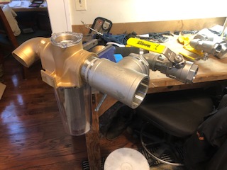

    Hello fellow Post Kids!
    It's winter shipyard time and I'm making some upgrades. One big project is adding 3" internal strainers from Groco. Going to switch to slotted externals and clean out the baskets periodically during the season.
    Big question I've been trying to find the answer to is- the strainers are bronze. The fittings/ hose barbs I'm attaching them to will be 316 stainless. This is due to what I could find, and needing to add a freshwater flush arrangement. If everything is bonded properly to the hull zincs do I have any concerns with electrolysis given the dissimilar metals? Thanks

    2,931
    Bronze and SS are really close on the galvanic scale, it should be ok.

    I'm beginning to see a trend in my research. Although it's better than 304 apparently 316 stainless has a weakness involving the welds being susceptible to corrosion in salt water. Castings like that strainer might be ok. Fittings such as pipe nipples are usually welded. I'm leaning toward now going all bronze. Nothing like buying expensive stuff twice. Live and learn

    Your opening picture did scare the hell out of me.
