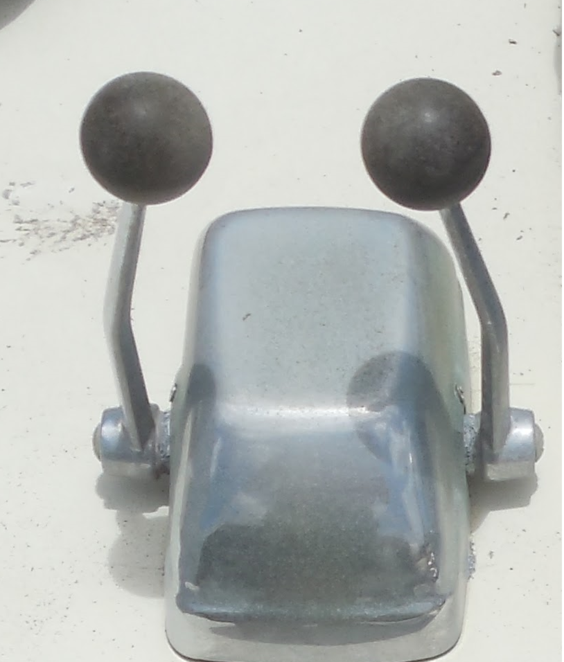

    I have a question for everyone.
    The controls on the upper helm consist of 2 levers for throttle and 2 levers for transmission control. My port transmission control is frozen due to corrosion of the mechanism. I am trying to google this device to find a replacement and am not sure what it is called.
    What do I call it? what term should I google for?

  13. CSlaughter
    CSlaughter New Member
    Feb 5, 2015
    17
    Austin, Texas
    Yes, I have already disconnected the cables and confirmed that it is the actual lever it's self.

  15. Capt Ralph
    14,522
    That's not the style I was thinking of. Maybe older TeleFlex, I'm not sure.
    By the look of that monkey metal puffing up, new controls could be an easier fix (less blood loss).
