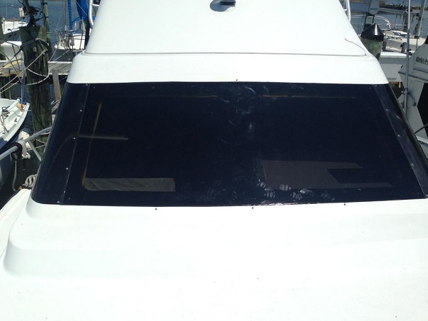

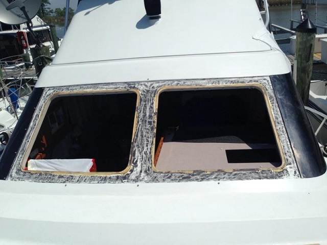

    A couple of years ago, over the winter, my 1994 boat (35' Luhrs SF) developed a crack in the windshield requiring replacement. It was replaced with an equivalent plexiglass material, but instead of a single piece, was split into a port/stbd window with a small center piece. I've included pictures of the open window frame and the newly installed plexiglass.
    Initially the vendor used some sort of roofing caulk, which worked fine until the heat of the summer (Maryland) caused the expansion/contraction of the plexiglass, which caused leaks from the top of the window inside the boat (not from the center). After several iterations of removing and re caulking, with the same results, last spring the vendor went to a new caulking product SikaFlex 295UV. This product worked for a while, and we thought we had the problem solved.
    After a full season of running, we recently saw the reappearance of leaks, although much less water than before. I'm positive that the leak is coming from the windshield because I placed shrink-wrap tape over all seams for the window, and there are no more leaks.
    I have been reading multiple internet articles that seem to recommend the Dow 795 sealant as the best for this application. It is my understanding that this sealant is used to affix the glass panels to skyscraper buildings (handling the expansion/contraction), and is compatible with the plexiglass material.
    I am planning to have the windshield removed and re-caulked this spring, and want to ensure that the best caulking material is used to hopefully resolve this issue. It is amazing that the factory windshield that
    was replaced (23 years old), never leaked. Unfortunately Luhrs is out of business, so I'm unable to ask them for the specific sealant that they used.
    Thank you in advance for your comments and suggestions! Kevin

    Wow - Thanks for all of your responses - I was thinking I had only two choices and it looks like I have many more options to choose from.
    I will investigate all the products mentioned and will also consider replacing the entire windshield with a single pane of glass.
    Capt J - You are correct that the initial plexiglass that was installed did warp in the summer heat. The vendor removed and replaced with a thicker
    size of plexiglass (don't recall the thickness sizes right now)and then warping was no longer a problem.
    Rcrapps - Interesting point about the twisting - one point to be made the windshield also has countersunk screws along the perimeter holding it down in addition to the sealant (hard to see in the pictures). This was how the factory did it. The original crack was in the center of the pane opening on the starboard side. We can see the leaks (thru the glass)coming from the top seal, dripping down the interior of the pane, not near the split.
    Yes, I also I thought about fiber-glassing the whole thing, but we like the natural light that it provides and prevents the SF "cave" feeling when at anchor or in port.
    Again thanks to all for your thoughtful suggestions!
    Kevin
  11. Capt J
    14,652
    Your going to need to go to glass. Plexiglass no matter how thick, doesn't have the dimensional stability in the heat and will still warp and move no matter what the thickness as well as overheat and release the sealant. You could try another sealant such as some of the ones mentioned, but I think the summer heat is going to cause the plexiglass to release most all of them.
