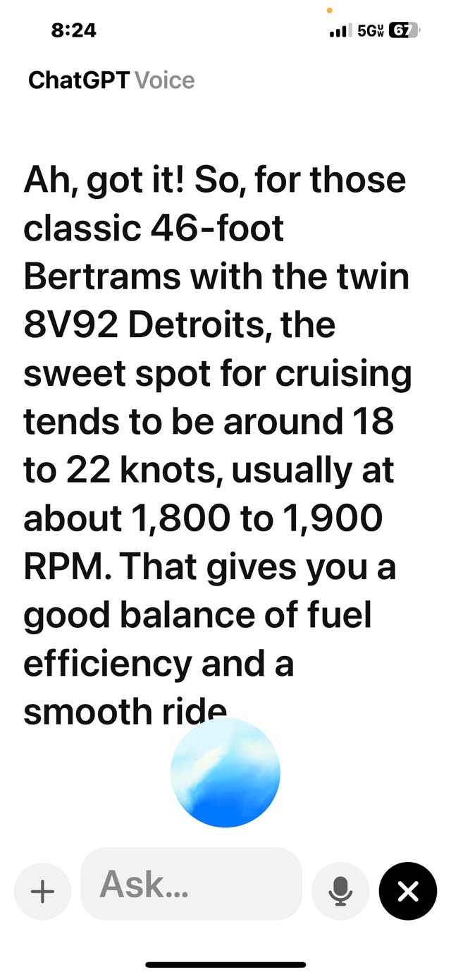

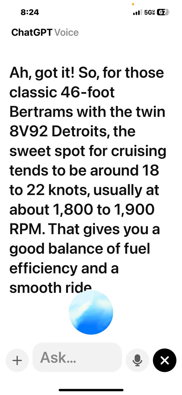

  3. rayduncan
    rayduncan New Member
    Feb 19, 2026
    4
    biloxi ms
