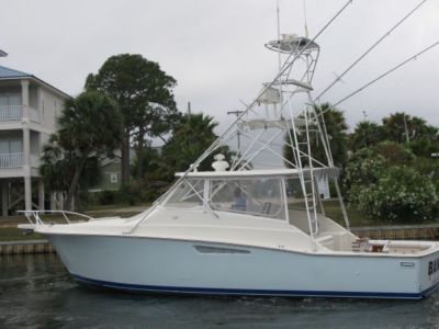

    That's a great looking boat. It's amazing that by simply removing the old windshield the boat looks completely different. At first glance you wouldn't recognize it as an old 38 special.

    I agree that the boat looks really good without that 3' high ugly windshield that they had. A survey should determine the structural integrity of the boat.
