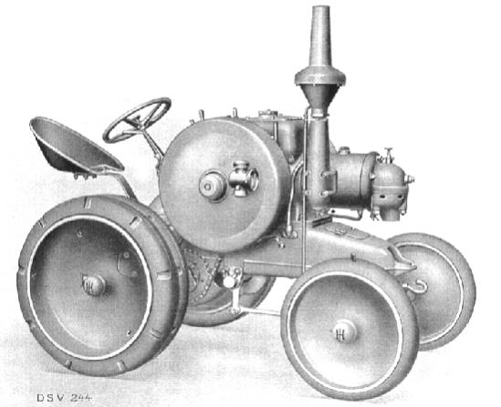

    I believe, he means by decompressing the cylinders, the starter would have an easier job. Then letting the button go and the engine would start immediately. Thats the way, the very old diesel engines (like the hand cranked old agricultural tractors and early single cylinder long stroke diesel) were started.

    Then it does not make sense at all, other than a dry crank. It was the only reason, I could imagine.
