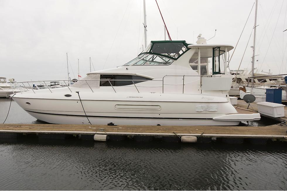

    I am looking for reverse backup camera’s for my 4450 aft cruisers.I have been looking and found the raymarine ones are so expensive. I wanted cameras because I really can’t see backing up. This will be my first year with docking a aft style boat. Kinda looking for two cameras one for each side so I can see, and watch when my wife steps off the boat. I just purchased the raymarine Axiom 12
    So I’m sure I can split the screen with the camera. I also have to figure out how to be able to see one camera at a time, not going to need both camera just either side depending on port or starboard tie ups . Any help would be greatly appreciate
