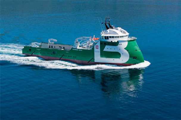

    The improved efficiencies and enhanced sea-keeping are quite impressive. I understand Damen has delivered at least 4 axe bow fast patrol and supply vessels, and hint at the yacht market. While they state a prospective yacht owner would need to be enthusiastic about the modern design, it is also an invitation for rebirth of some classic profiles.

    The point was not that the axe bow was anything radically new, as I understand the Vikings built them a few years ago.
    They are interesting test results for fast patrol and supply boats especially in built seas. The numbers are significant improvements over conventional hulls.
    I thought this might be applicable to some expeditions and trawlers, that tend to be out in the nasties.

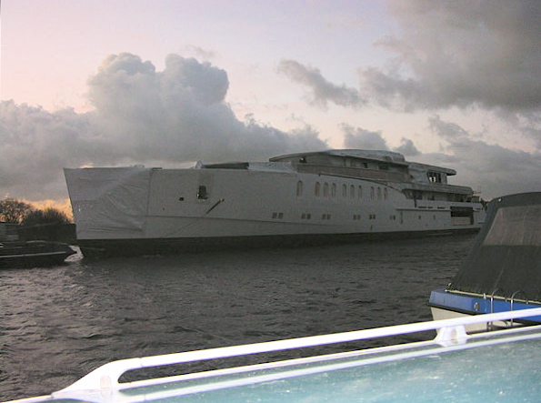

    I donĀ“t know where the borderline between axe and wave-piercer bows goes really, but it will be interesting to see how the Feadship above and the project Sigma will perform when they are launched. Having a luxury yacht where salt water is sprayed all over it may not make the crew (or owner) happy at the end of the day..?

    My reference point, is of course Anemone at 80metre so that is the application that has me going Hmmmm. What works at 30 metre or 150 metre doesn't necessarily translate to 80M. Bulbs make me nervous when it comes to ice. :(
