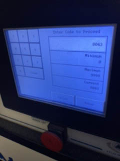

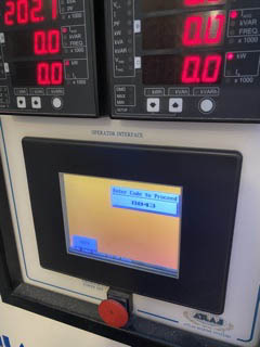

    Having an issue with our Atlas ShorPower II
    breakers tripped on the dock. Reset. Atlas started but is not connecting.
    control screen is locked with a prompt to enter a 4 digit code that is displayed but it s not taking it.
    anybody seen this? I d rather not to be on gen till they open on Monday...

    I haven’t tried Ward. Just Atlas. I had an issue 3 weeks ago and one of their tech walked me thru troubleshooting and a reset. But that was on a week day.
    what’s odd is that the Lock Screen tells me what pin to enter. I went thru the manual and found another PIN hand written next to the first one That didn’t work but then when it asks for a pin it tells me to enter the second one. Makes no sense.

    Unfortunately no. I checked everything incl the manual. Plus from what i understand the atlas replaces the isolation transformer so no neutral coming aboard.
  8. Pascal
    8,166
    Turned out to be a comm issue between the screen and the CPU. A quick call to Atlas this morning got me back in business by recycling a small switch on the CPU.

    No a full power off didn’t reset it. had to cycle the tiny switch inside the panel
