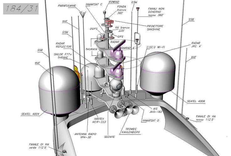

    Having seen that many designers well respected from the entire Yachting community are members of this forum, I would like to ask their opinion about the mast which shall be installed on Our Yacht. The following design has been prepaired as the equipment which shall be installed is many and We have tried to respect each manufacturer recommendations. The Yacht is a Maiora 31 and all opinion are welcome. Please note that we haven't proceed with the construction yet as I wanted the specialists opinion

    Lot of stuff up there. Having just spent quite a bit of time dealing with issues with our seatel, check on the seatel specs for distance from the radar.

    Both Radar Antennas are placed higher from both Seatel antennas. But apart of this whats your opinion about the appearence?
    Talking about the staff you have to see the W/H and fly bridge stations

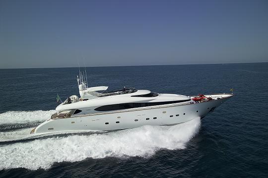

    Hard to say without seeing a complete vessel profile drawing, I suspect for such a sleek yacht as a Maiora 31 it may be a bit much.

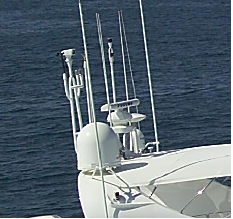

    Below find two photos of the an ordinary Maiora Yacht . In the first photo is the standard maiora 31 mast, and the second shows a maiora 31 profile

    You might get away with it. But on closer viewing I was bothered by the size of the tubing that the mast is made of and wondering if it will support all that stuf without flexing, I am assuming that the structure is built with 50mm (2 inch) pipe

    If your specing a dual-axis SEENITE, you might consider the highest possible location on your mast for full 360 viewing. The GPS receivers would also benefit from increased separation from the mast. And finally, (and to me, most importantly) move those KALENBERG T3's to over the wheelhouse, infront of the FB). Nothing like repeated toots from those babies behind you to make you type in all caps!!!

    First of all the entire roll bar is made by carbon fiber and epoxy resins as per my order to the shipyard. As per the metal structure shall be made with 1 1/2 inches tube

    The ideal position of the seenite would be on the top but having in mind that it will be used for navigation purposes thus +-90 degress vissibility is ok and the weight of the seenite itshelf is about 50 kg, We should have an enormous mast thus an ungly looking structure for this yacht

    1 1/2 inch tubing for the mast structure sounds a little light, I would be very concerned about the structure flexing. I am sure the arch will be fine.

    Regarding the mast tomorrow I will review the drawings and propose the incorporation of 2 inches tube. Thank you Garry for your kind assistance

    May I suggest iust raising the concern and let the designers figure out the detail as I am not even sure that 2 inches would be correct. I just think 1 1/2 is a little light.

    According to the Shipyard's Project manager 1 1/2 inches should be ok. Now I am worrying

    Well if you raise the issue and document that fact then if there is a problem at least you can go back to them to fix it.

    Make sure you put in a very strong specification for isolation of stainless steel fasteners in a carbon structure.
    If you think aluminum and stainless react badly, you should see carbon fiber and stainless. Looks like a lot of fasteners will be screwed into that structure.

    Just eyeballing the thing, I was wondering about that tubing myself. For appearance sake, if not strength, I would be tempted to replace it with a short length of mast from a sailboat? So the dimensions would be much, much larger than just 2 inches. Plus the sailboat mast material would have a very pleasing oval shape to it. Of course all those brackets would need to be redrawn ...
