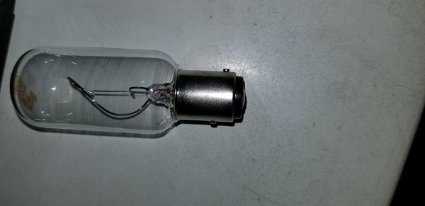

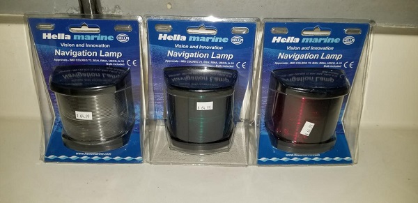

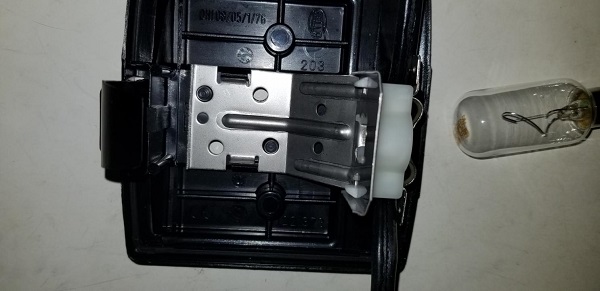

    I ordered red, green and mast head in black plastic. White is available also. The seller combined the shipping on all. Just came in today, Wonderful packing and verified the same 32Vdc lamps do fit.
