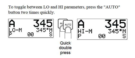

    If your autopilot is not connected with a GPS or other speed sensors, you must select the speed, HI or LO yourself. Another issue could be air in the hydraulic pump...

    Well it turns out it was a simple correction. The autopilot is connected to GPS but when this problem occurred we were just running a straight line on Auto. Turns out a friend who was running the boat had inadvertently pressed the auto button and the autopilot had moved to the Hi position creating an oversteer problem at high speed.
    Thanks to all for your information.

    It sounds like there still is room for improvement in the pilot calibration. Simrad, like many other pilots, uses two sets of steering parameters high and low speed and switches between them based on speed from a connected (and configured) GPS or paddlewheel input. Most often the self learning mode does a good enough job when done by the manual instructions but the manual also says to do it at a slow speed. The unit then extrapolates high speed parameters from that data but the correlation isn't always linear.
    I've found on many high speed boats, especially ones with power assist steering, it helps to do the autocal routine at cruising speeds instead. Simrad recommended this to me years ago when we had similar problems when manually inputting different parameters didn't seem to help. You absolutely have to have plenty of open room to do this and make sure you are holding on tight as it may very well jink the boat violently at first. Also make sure it is configured and recieving GPS speed data so it knows what speed you are travelling at and will reprogram the high speed parameters accordingly. You may also have to adjust the low/high transition speed if it differs much from your planing speed.
