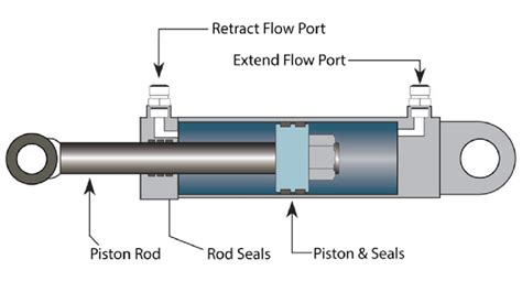

    Well, If the ram piston seal was leaking, the cylinder could sag even though the pump check valve is holding.
    You would never see an external leak.
    I'm assuming 2 line cylinders.

    Then an internal piston leak is possible.

    If there was an internal leak, the fluid from the up line would leak past a seal into the down line, right? Wouldn’t the valve at the pump prevent fluid from coming back into the reservoir?
    I guess one way to test would be to add valves at the pump outlet to isolate both lines and see if it still drops
  10. Capt Ralph
    13,651
    The fluid stays in the cylinder, just leaks to the other side of the ram piston.

    Yes I get that and from there it would push back in the hose. But to get into the reservoir it would have to go thru the valve block so there would have to be a leak there too
