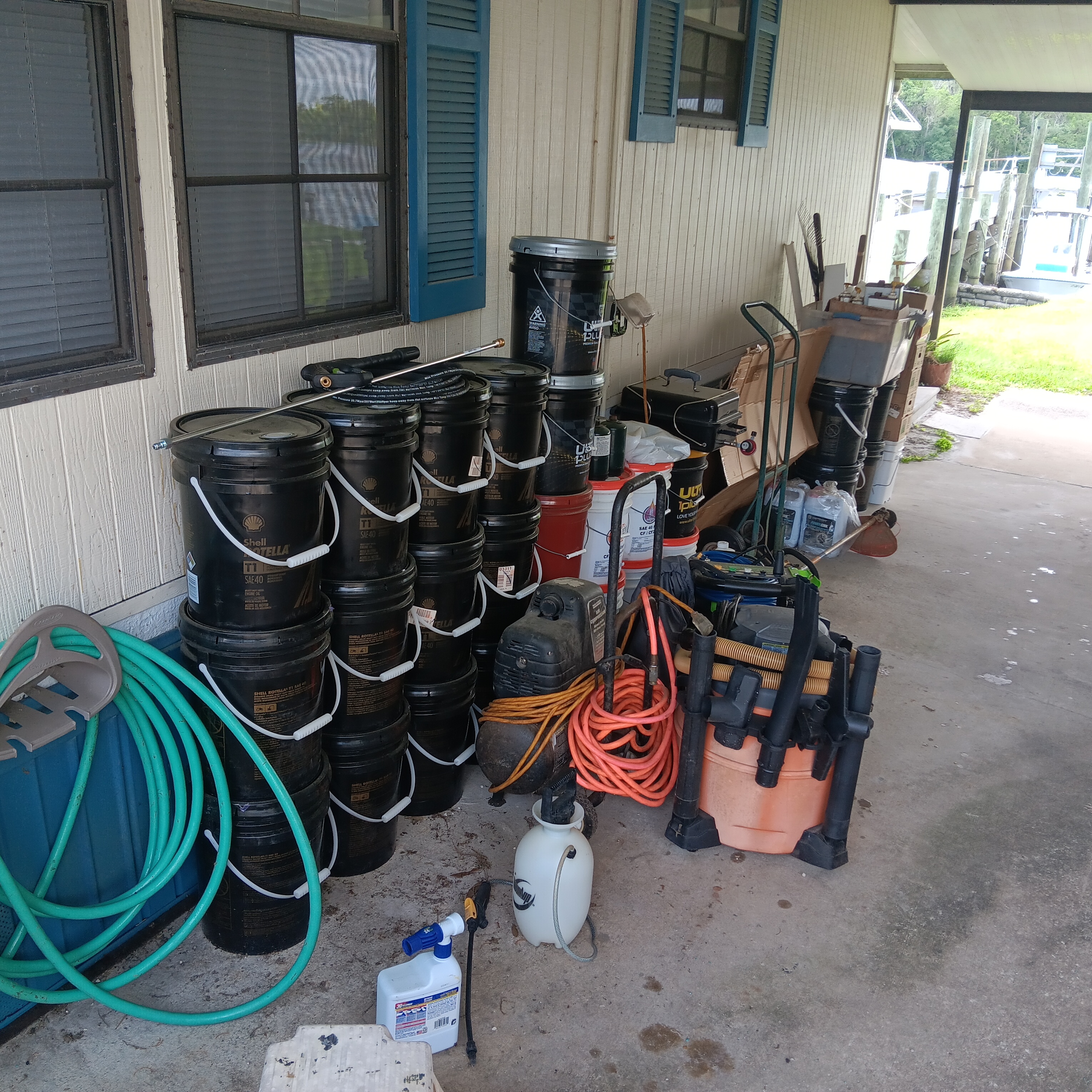

  10. Capt Ralph
    14,024
    Please don't tell me you paid that much.
    Amazon does deliver a cheaper oil;
    https://www.amazon.com/Republic-Diesel-gallons-Compare-Chevron/dp/B0CH1V8GVF/ref=sr_1_1_sspa?crid=1NIOFXRQHJ9TV&dib=eyJ2IjoiMSJ9.HybSY7PQEk2k8n2T5CZ3Aw.CfWoAay7AilQ5mCwGqc40i-BhVPtIGvG0NhqfF6CO9E&dib_tag=se&keywords=republic+cf2+oil&qid=1757901336&sprefix=republic,aps,179&sr=8-1-spons&sp_csd=d2lkZ2V0TmFtZT1zcF9hdGY&psc=1
    I have not paid that much in years either.
    On my north wall is this years inventory for two boats. I still have pails of Mobil oil on the south wall.
    If your going to shop for oil, arm wrestling and quantity get involved.
