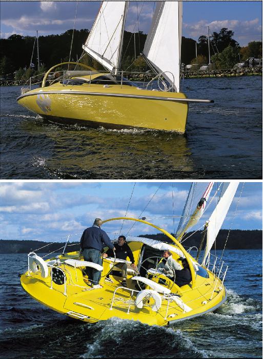

  4. AMG
    5,378
    Never been on a boat with that kind of keel but on this one, called One 40, which has both ballast or trimtanks each side under the cockpit and a ballast weight on a rail under the main salon that slides from side to side. If I recall right it is 700 litres of water and a 700 kg weight. Very special design as always by Guy-Christer Lönngren and she is a fast sailer. Interior is like a spaceship and very elegant. I can sell it to you for USD 200´ ;)

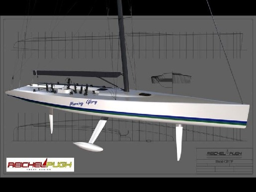

  9. Doug Lord
    Doug Lord New Member
    Feb 7, 2005
    3
    Orlando/Cocoa, Florida
    CBTF
    Canting keels are probably one of the most significant breakthrus in sailing yacht design in the last 50 years(along with the Moth foiler!).
    They have been around over twenty years and have an excellent safety record and an unmatched race record. Even with the individual component(fins, bearings ,rams) failures recently and perhaps a design failure on a couple of boats all the major ocean races of the last few months(years?) have been won by canting keel boats including the Sydney Hobart, Pittwater Coffs and the Vendee Globe. The upcoming Volvo crewed round the world race will be won by a canting keel boat since all of the boats have canting keels!
    CBTF is a patented system whereby the keel fin is reduced to just being a strut and doesn't develop ANY lateral resistance at all. The lateral resistance function of the boat is 100% taken care of by twin fore and aft foils that the CBTF guys call foils and not rudders because their main duty is to develop lateral resistance. When the two foils are turned in opposite directions the boat turns in a turning radius about half that of a "normal" canting or fixed keel boat-making for quicker turns and better manouverability than a conventional fixed or canting keel boat. But the biggest advantage of the CBTF boat over other canting keel boats and over fixed keels is "collective": when both foils are turned the SAME direction upwind virtually eliminating leeway in regards to the hull and allowing a better VMG to windward than just about any other yacht.
    Future canting keel incarnations will see hydrofoils used to lift the boat with a flap on the canting keel fin to increase righting moment.
    All in all canting keels represent one terrific way to go fast in a monohull with a lot less lead than a fixed keel raceboat!

  11. Doug Lord
    Feb 7, 2005
    3
    CBTF
    CBTF wasn't used in the AC but twin foils were used. CBTF is Canting Ballast Twin Foil. The twin foils did show promise back then.
    Any course that has a lot of windward work will be particularly beneficial to a CBTF boat ,but they're good on any course-at least according to their results and the CBTF guys I've spoken to.
