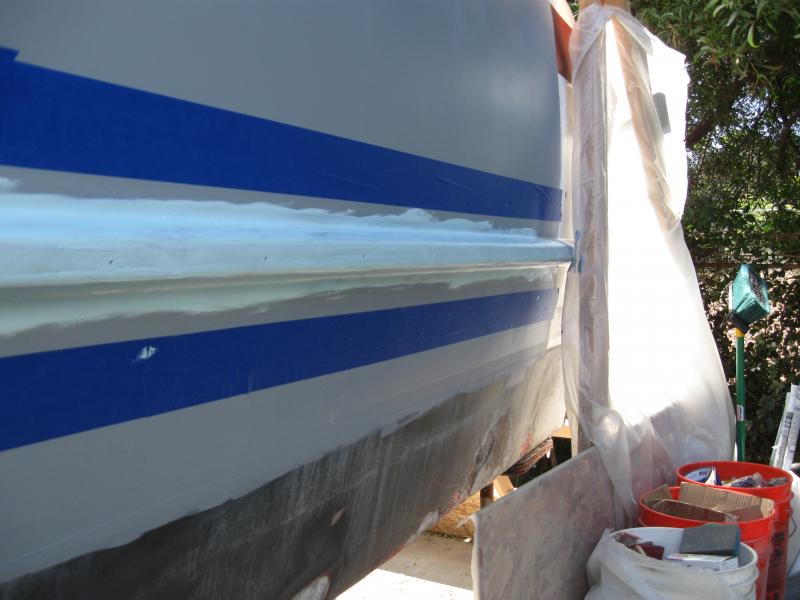

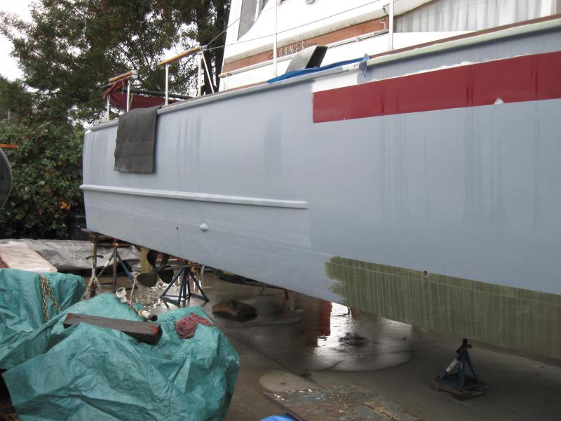

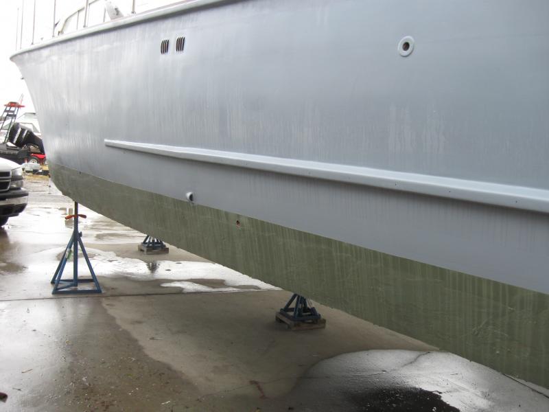

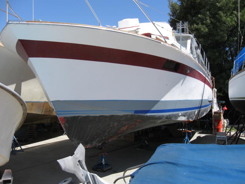

    Established "NEW" waterline with interlux 2000E level with rear chrome mount.
    This is my revised limit for the under water prep and paint.

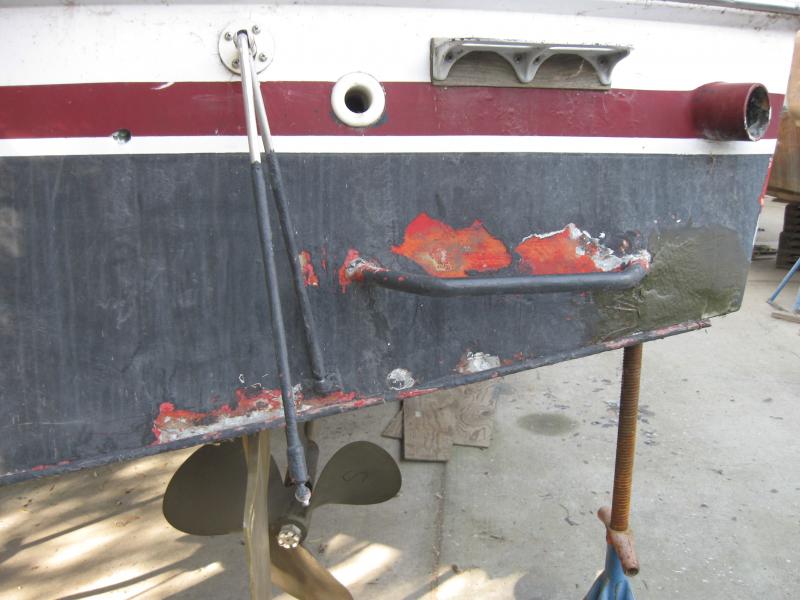

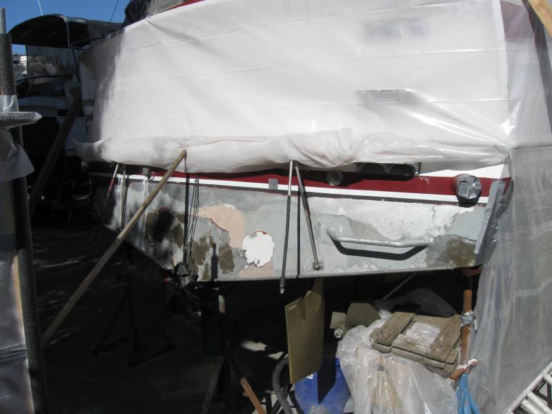

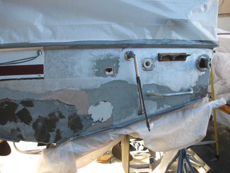

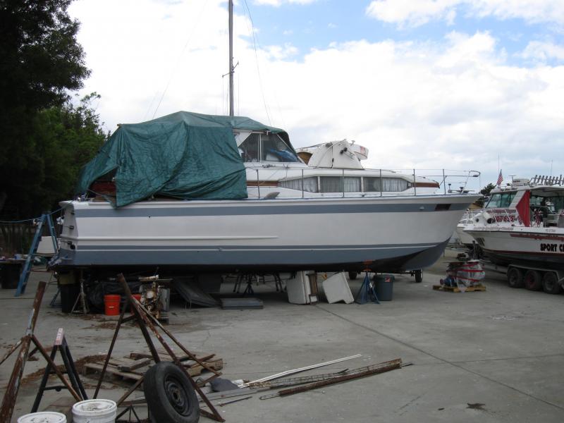

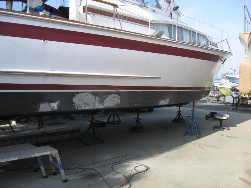

    conditon upon arrival in CA
    The journey from Kenosha to CA was a bit tough on some of the old marine bondo work by the PO

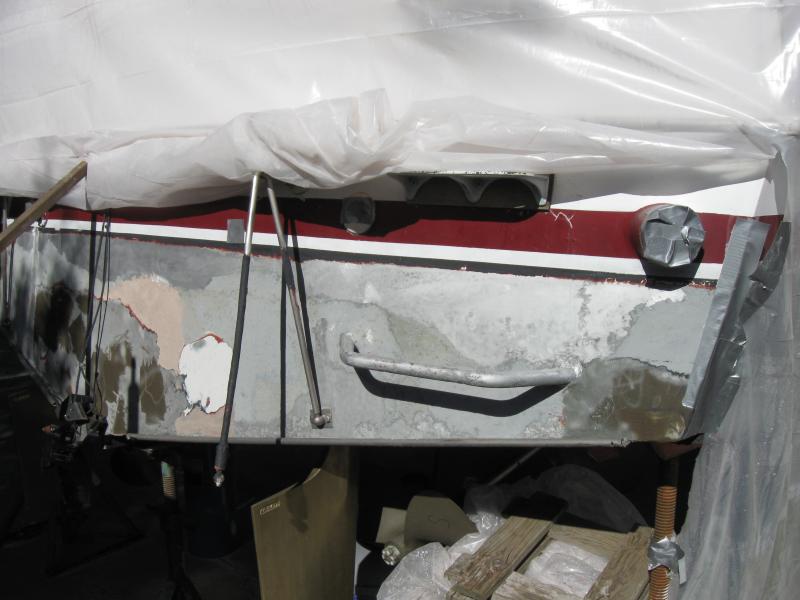

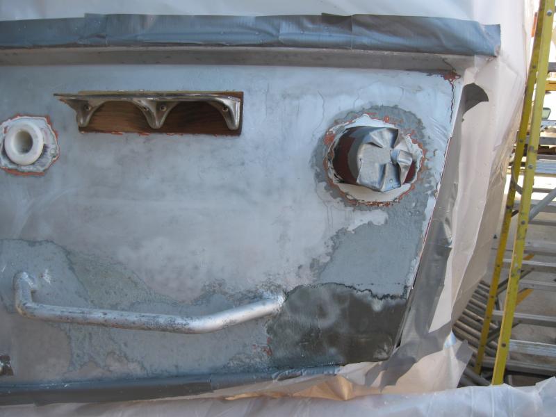

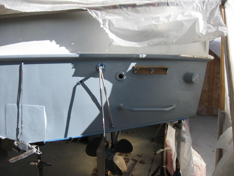

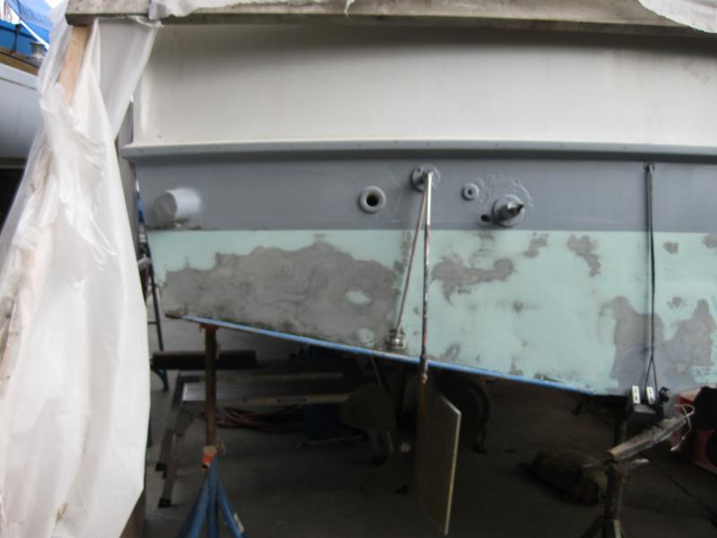

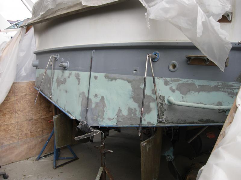

    So off to stripping the transom first
    Tried a few things. The coal tar bottom paint was a major pain. The yard cried uncle, I then tried a small soda blaster and then moved up to a sand blaster.
    I found that a mixture of soda, sand and glass media did the trick. Soda took off the paint fine but not the orig chris craft fairing bondo

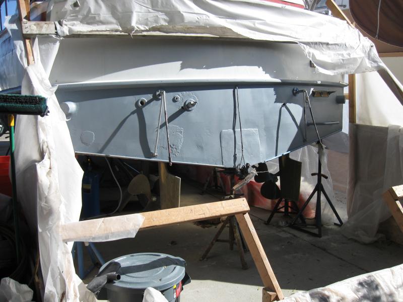

    then used epoxy primer base coat
    Interlux 2000E on sanded and degreased bare aluminum

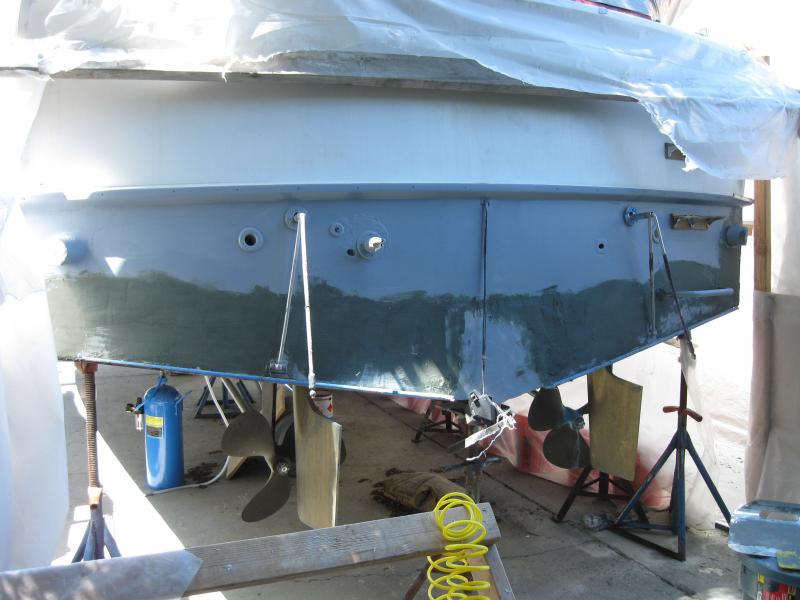

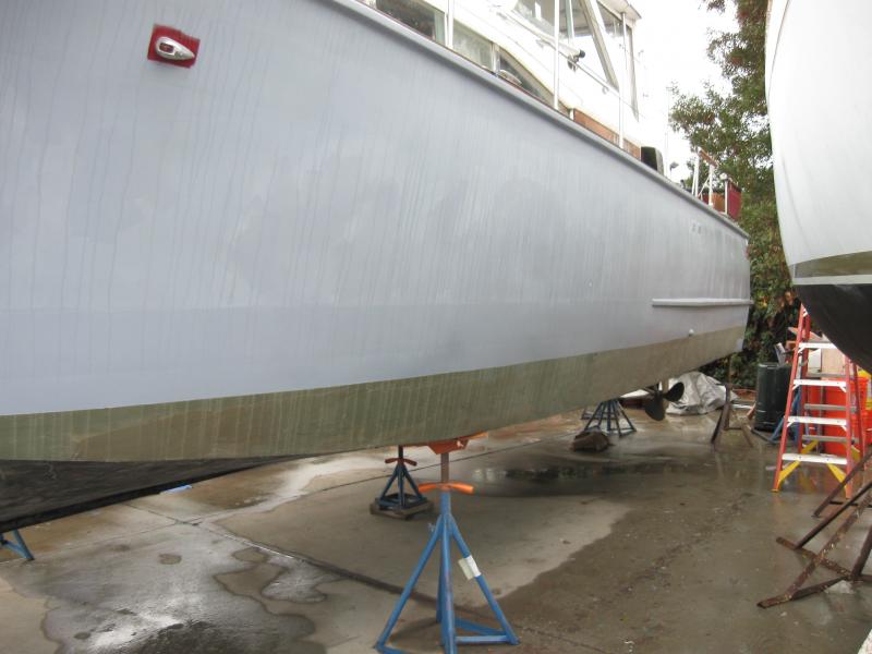

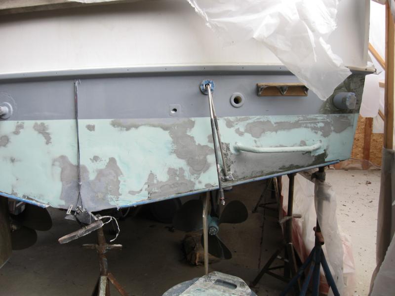

    Then glass filler
    Used dynaglass fiberglass filler
    Found this stuff to be most affordable but has quick set up time and is kinda lumpy especially as it sets up under application in summer temps.
    Typically this stuff is sanded smooth.
    I used this up to the "NEW" waterline.

    Interlux glasstite filler
    Used this product as a final smoothing coat, much more workable

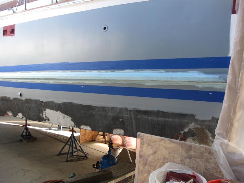

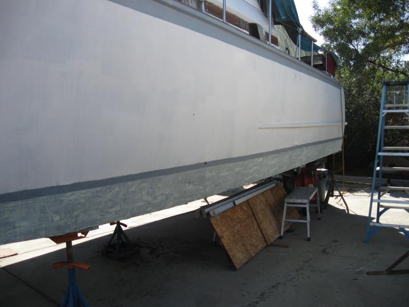

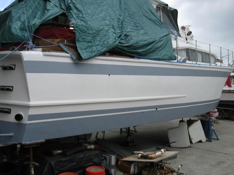

    upper hull
    I did paint in lifts to make tape lines at water stripe and upper strip so that I could match them.
    Sanded hull sides and spot fairing in spots the painted with the interlux 2000e

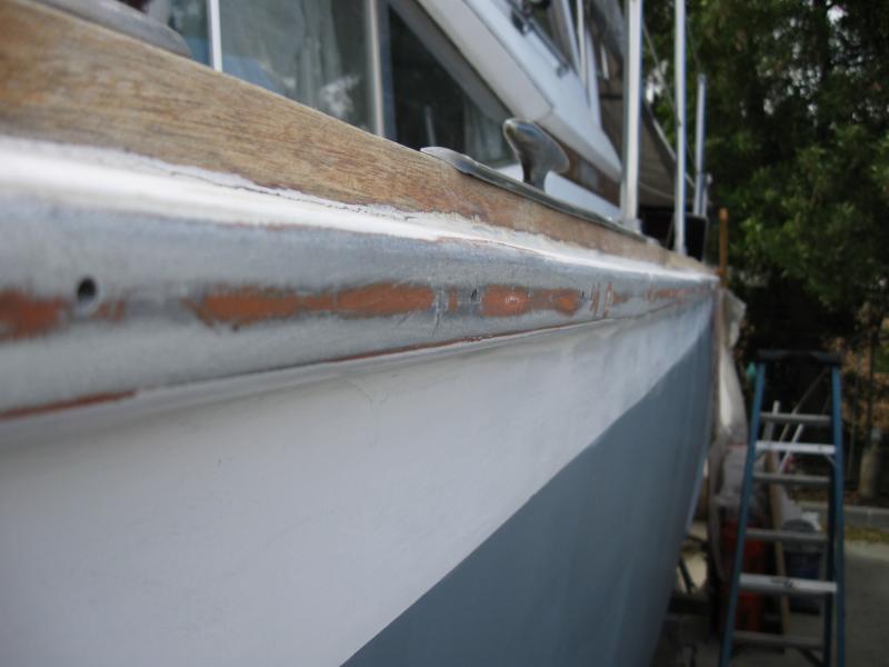

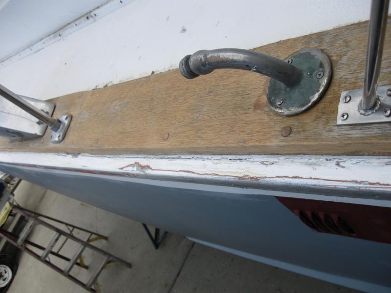

    toe rail and moulding strip
    Sanded to bare metal, interlux 2000e and watertite fairing

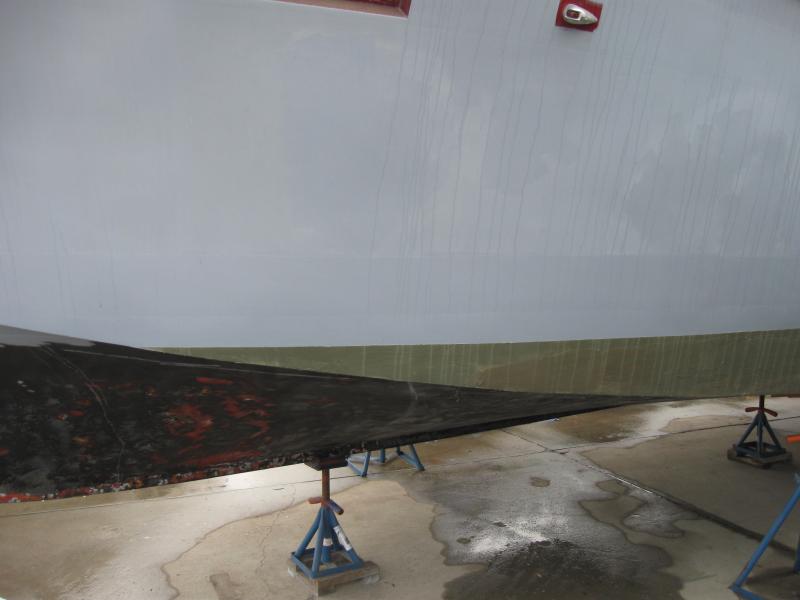

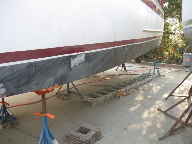

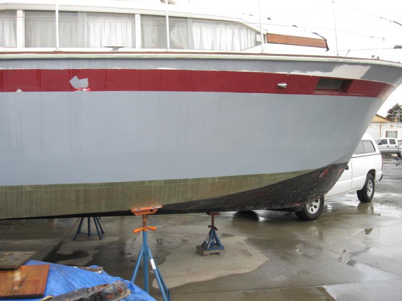

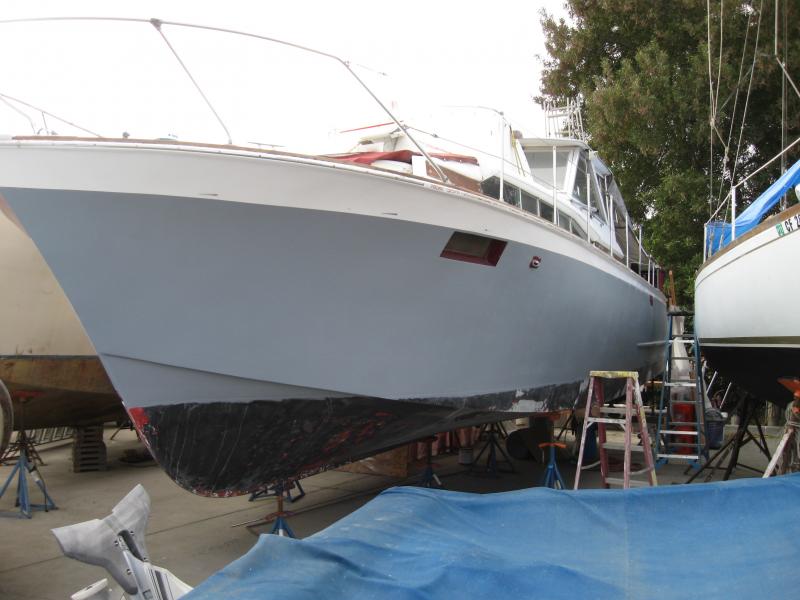

    OK back to the coal tar
    On the hull sides I chose to go with sanders. Lots of hard work.
    Advice to those wanting to do this job, rent a commercial blaster and do it in one big push. It was my orig plan but here in CA the yards are under too much enviro scrutiny.
    Find a barn or rent a shop and do in a weekend, time lapse here is a summer and spring for this one man band

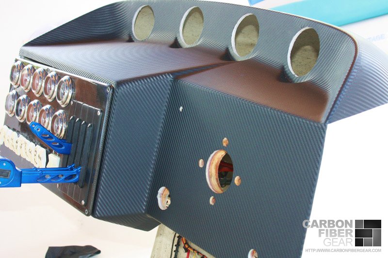

    3m di-noc
    U name they have it
    Marine teak
    Mahogany
    How about marble or carbon fiber

    3M Dinoc on boats
    It seems the di noc crowd loves the carbon fiber look.
    There are hundreds of examples on cars, here is a couple boat applications

    Finishing touchs on primer and filler
    Final smoothing coat of watertite filler
