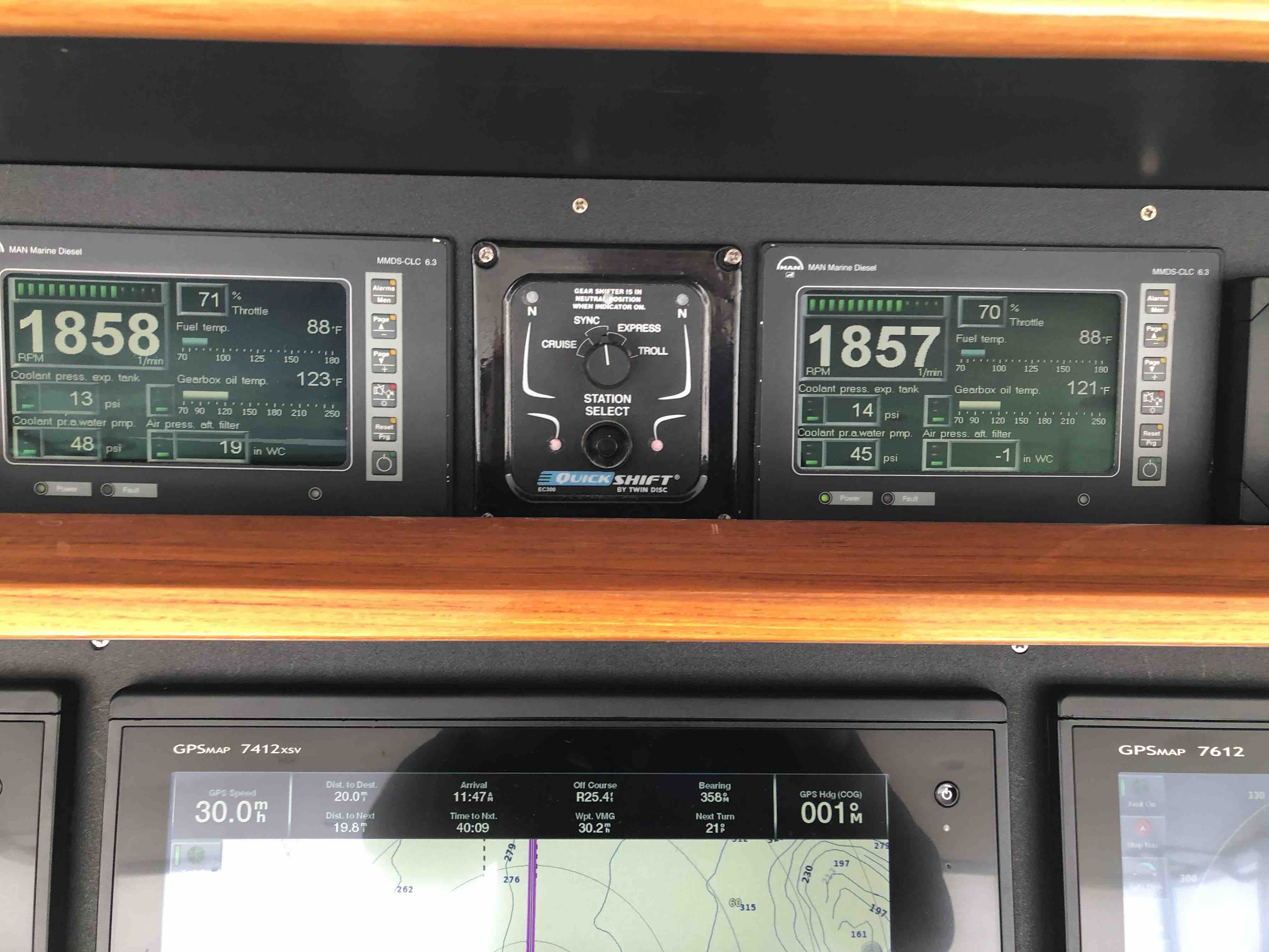

    I just noticed something a little unusual. Man 2848 engines. I have a disparity between Port and Starboard engines (see photo) and I have no idea what the heck Air pressure Aft Filter in WC is or why we have this disparity and if i need to fix this and how. Everything seems to run normal but I am curious of what this is all about. Anyone have any idea?[​IMG]

    I just heard from my mechanic and he said- The -1 is correct at that rpm. I would say the port sensor is defective. That’s about a $700 sensor.
    The positive pressure reading won’t trigger any faults because positive pressure is good.

    looking back at the old thread that Capt Ralph spoke about earlier I think its the sensor not the filter. It doesn't make sense to me if the number is positive that it could be the filter.

    Positive pressure actually isn't "good", it's a nonsense.
    I was in doubt about whether the MMDS display reading should show pressure (hence a negative number to be expected) or SUCTION (hence a positive number).
    In fact, if you look at the video posted by F42, his displays (which are the predecessors of yours) show SUCTION, with a positive number.
    In other words, they reversed the logic, over time.
    Anyhow, the bottom line is that you are probably right in thinking that port sensor is defective.

    Yup, because you have the displays configured as metric: boost pressure is also in bar.
    The OP numbers, port sensor anomaly aside, can only be in PSI.

    good catch- just to confirm- this is a 675.00 part without freight from another vendor I checked as well. joy....

    The unit of pressure in question is "inches of water column". This reading is an absolute pressure, we commonly refer to this as a vacuum. The 19 value means that if you connected a hose from the tap on the air line to the top of a vertical glass tube and placed the bottom of the tube in a glass of water, the "pressure" (actually vacuum) would pull the water 19 inches up into the tube.

    Then the filter could be pretty well clogged up, or sensor not calibrated or bad.
    I would hate to think that air filter would be in that bad of shape.
  20. Marblehead01945
    Marblehead01945 Member
    Jul 25, 2008
    103
    Marblehead
    definitely not the airfilter. They are both in great shape and replaced at the same time so thats hard to imagine. My mechanic says its positive air flow not negative so thats the reason not to worry and probably the sensor.
