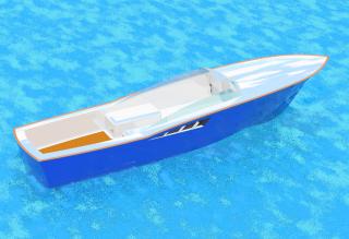

    This is a little toy I have been daydreaming about lately, 33ft Sport boat.

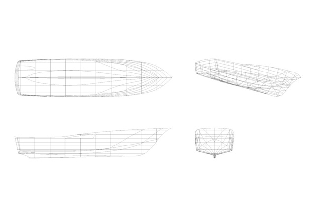

  2. Garry Hartshorn
    Garry Hartshorn Senior Member
    Jun 14, 2005
    504
    Directly above the center of the earth
    Carl
    Sorry about the sizing of that lines drawing I thought I had it right, but I guess not

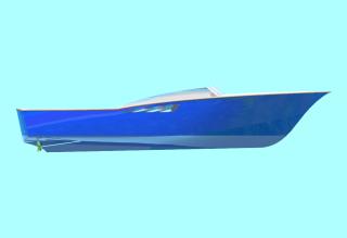

  3. AMG
    5,375
    Good looking boat! Maybe a little too flat aft part of the hull for higher speeds, but around 18-20 knots she will probably perform just fine.
    This hull shape is more often used in a bigger size, like 50 feet where the displacement is softening the ride.

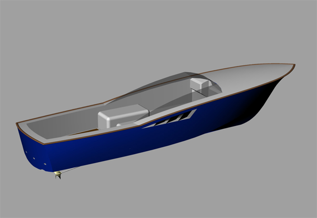

  5. Garry Hartshorn
    Jun 14, 2005
    504
    A little clearer view

  6. KCook
    KCook Senior Member
    Jun 24, 2005
    1,160
    Phoenix
    The form of the hull bottom got my attention too. Appears to be low prismatic coefficient, does this mean it's meant to be a semi-displacement design?
    As for the styling, that is certainly a proud bow. But I wonder if the helmsman can see over it?

  8. Garry Hartshorn
    Jun 14, 2005
    504
    Basic concept of the vessel is that it is maximum trailerable size in New South Wales. Is relatively ecconomical and can handle a nasty bay chop. Hense the fine entry, shallow deadrise aft and the high flared bow.
    With a pair of 125 hp Yanmars or similar she would comfortably cruise at 20 knots with a top end of 25-26 knots.
    The otherthing you can't see in the pictures it that there is a step between the engines and that the forward cockpit deck is raised, so when standing at the helm " stbd fwd " you will be able to see over the bow, when seated the view will not be obsured but not great
