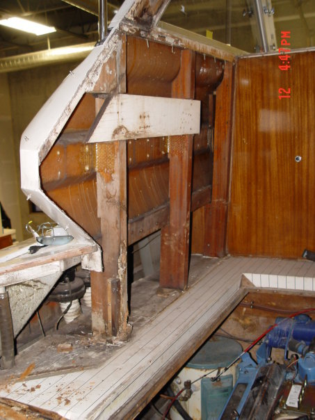

    The last week I removed one cross member support joist for the aft deck. This joist, (as are all the others), was bolted to the aluminum frame which is part of the aft deck support. When I removed the beam and bolt there was a small tab of white rubber like material between the wood and the aluminum frame. My guess is that this is a vibration isolator.My question is what should I use in its place? Here are a couple of pictures of the project and the rubber like tab.

    I would use some neoprene rubber, you could probably glue it down with a little 5200 just to keep it in place

    I used butyl rubber. As long as you maintain the thickness, it should fit together.
    Additionally, one might consider some supports to the sides under the hard-top supports (on a 37 foot model). Not only is this a likely location for rot, I think the floor on mine sagged in this area, further promoting water pooling and rot of the wood.
    Good Luck
