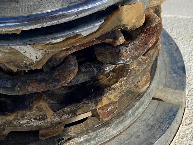

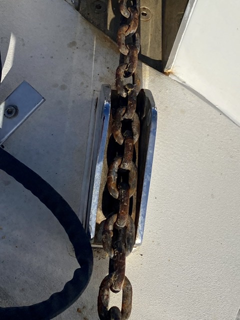

  8. Pascal
    8,119
    Sure. Not too bad yet but in a year it will be bleeding all over the deck.
    00752C58-CC6F-41DB-B57A-BA2C87727426.jpeg 385DD323-3424-4A57-BF91-9B1E3C72367A.jpeg

  10. NYCAP123
    11,205
    That's pretty ugly, but it looks like electrolysis.

  13. Pascal
    8,119
    I ve been greasing the gipsy to prevent the chain from getting stuck. The strippers on the Maxwell are not strong enough and I m tired of replacing them and the hawsepipe they re mounted on. The grease really helps.

    Ketchikan, Alaska
    That chain is ugly for its age. I have 8 year old chain that looks way better and I anchor a lot too.
