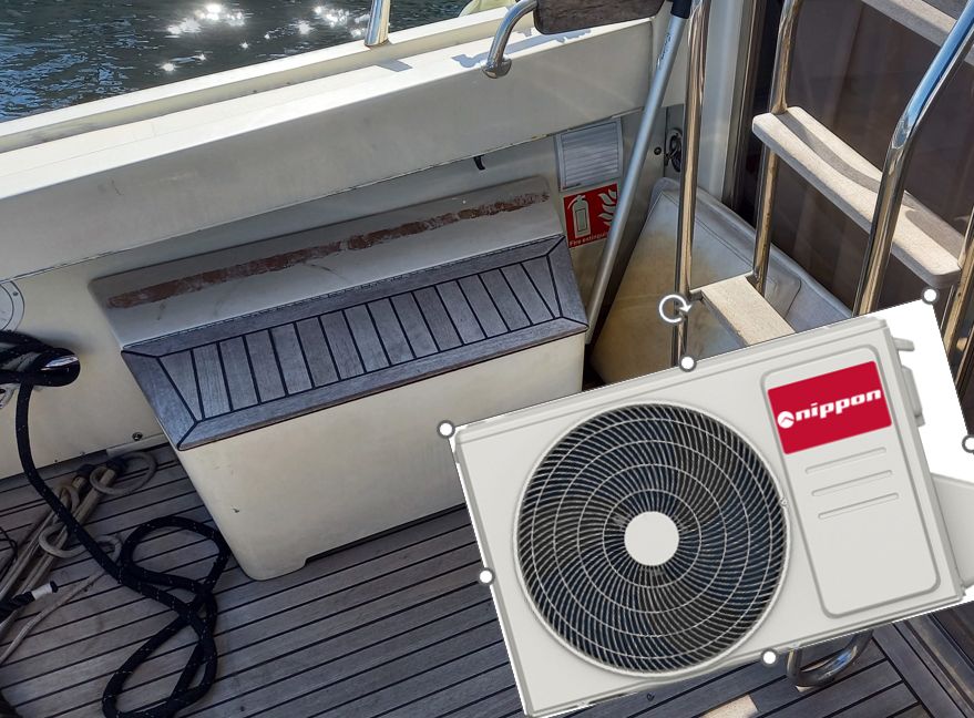

    I have been debating what to do with replacing old Cruisair units on my boat as well. Not so much for the flybridge but for the cabins. Unlike sailboats, we have plenty of space on our motorboats to put a household split system and tuck the outside unit somewhere in the cockpit neatly, so that it is barely visible. The obvious benefit is cost, noise and ease of maintenance.
    For example, a 12,000 btu system here costs Eur 700, it is nearly silent, inverter, remote, WiFi, all the goodies. You can put the inside unit anywhere and there are plenty of installers who do this for very little money. You don't have to deal with cleaning the strainer, opening and closing the valves, etc. If any part corrodes, you just replace it. The equivalent marine units start at close to $5,000, they are super noisy plus the noise from the running cooling water. If any maintenance is required, you have to go deep in the boat, even just to diagnose it (read: expensive service). Yet, most boats still have marine, sea water cooled units. Go figure.

    Mini splits are nice but the problem is where will you put the outside compressor? I can’t imagine having one in the cockpit like you suggest as it will be in the way, blow hot air on your legs and drip rust streaks all over…. Only possibility would be under the FB housing as long as have adequate ventilation, possibly with additional blowers

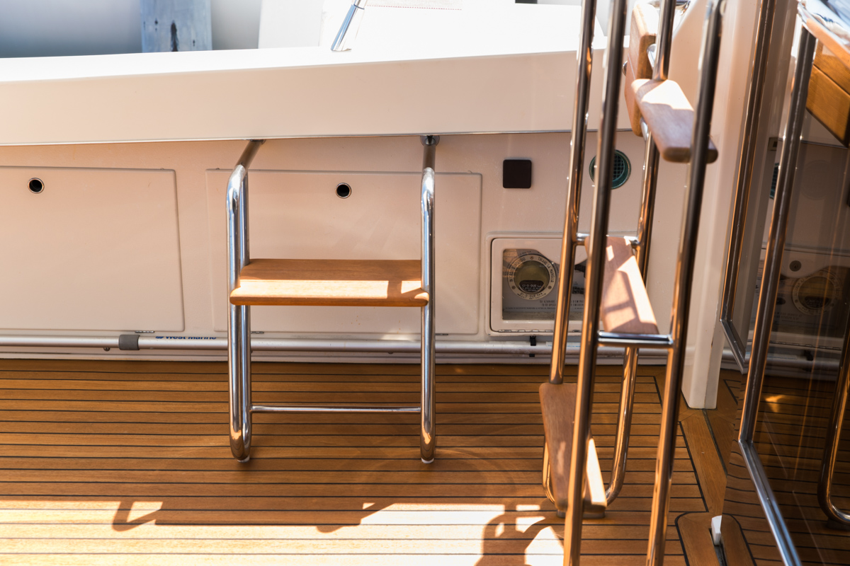

    I was thinking to install it in place of this box on the port side. Here a couple of pictures, if you can imagine how it would look like. It fits (I tried to put a scale picture) and will protrude only a couple of inches that I can cover with something, then put a step similar to the next photo. It can drain outside the cockpit, that is easy to do and then for the warm air, hm, I need to think about that, may be the cover can redirect it somehow, even with reduced efficiency. Sure, it is a compromise but then again, at 1/8 the cost and disposable.
