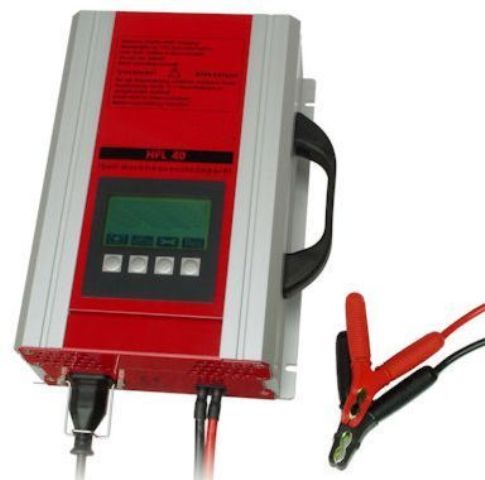

    Just buy a little mobile 3 step battery charger which charges the battery, refreshes it while charging and keeps it topped up (IUoU automatic charger). The picture below shows the type of charger, which is recommended by Mercedes. I use it for my historic cars (they only run ones a year). But there are cheeper ones on the market. Any car shop should have them.
