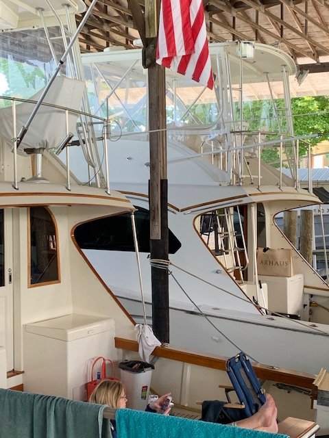

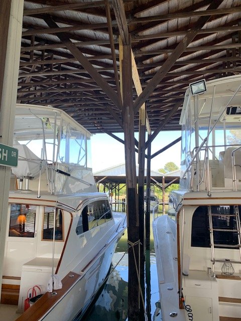

    My friend's new to him, Post 43, 1989, sits next to our '87 43. His boat sits about 4 1/2 or so higher in the water than ours.
    A quick measurement in the engine room, from between engines shows how much deeper, plus jumping into and out of his engine room, you notice. :D
    So I assume they modified the hull or its deadrise in '1989. Thought only the 46' was modified in that year.
    So what were the modifications? Every other measurements appear to be the same, salon, ceiling in galley, stateroom and bunkroom heights.

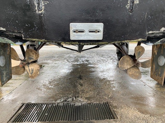

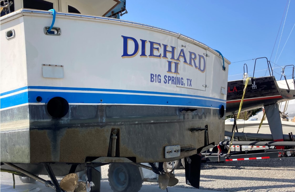

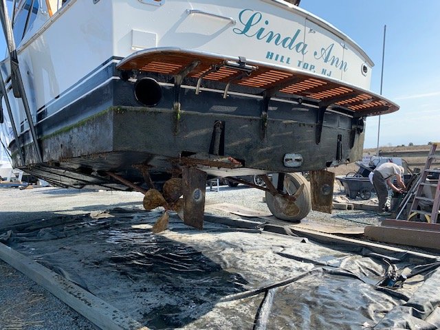

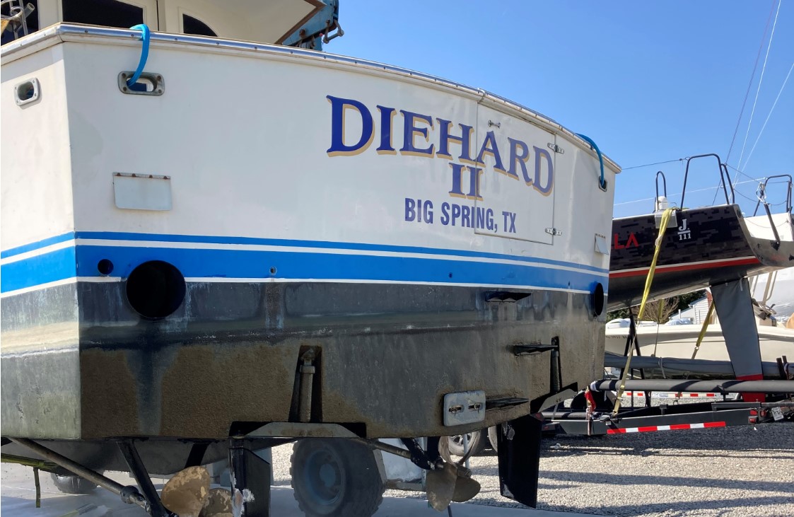

    So we both had our vessels hauled on Friday for power washing of the bottoms and zinc replacement. One after the other. Quick measurement from keel to bottom of rub rail at the stearn is approximately 9.6'" difference.
    There is definitely a hull change, his '89 hull runs deeper than our '87. As mentioned in my original post, I couldn't find any print on the topic but I'm sure someone knows the whens and whats of this change.
    Thanks for all your replies.

    Did you get photos of the transom view of both? Would like to see the difference and compare to mine.
