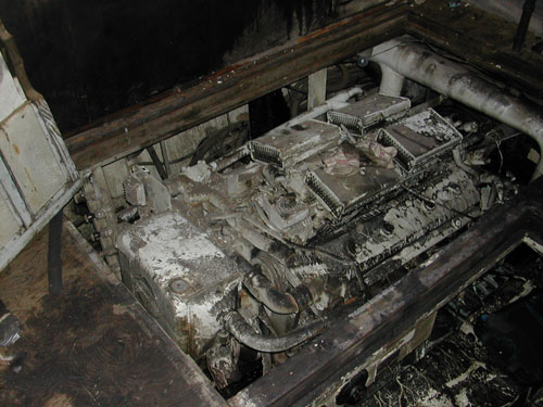

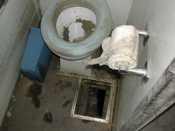

  11. valves etc...
    I moved my strainers last year to a remote mount. They were attached directly to the seacocks with a short nipple. A real pain to get at the packing also! A true seacock will have a 3 bolt flange inside, with a screw in mushroom head from outside. Never attach a valve to a straight thru-hull nipple!

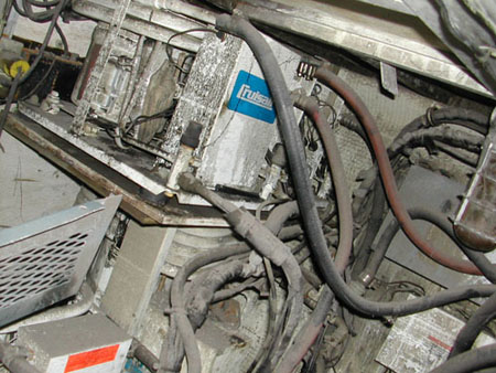

  14. North??
    Are youbringing the big guy up here or staying in G-ville? I can look out my window and see that bridge... I live in Lemont,Il. I had to drop my radar arch and the bimini cleared by about 3 inches; pretty darn close.
    [​IMG]
    [​IMG]
    Those old gate valves probably have crud on the seats/wedge. Try snugging them a TAD more with a big pair of channel locks. ws
