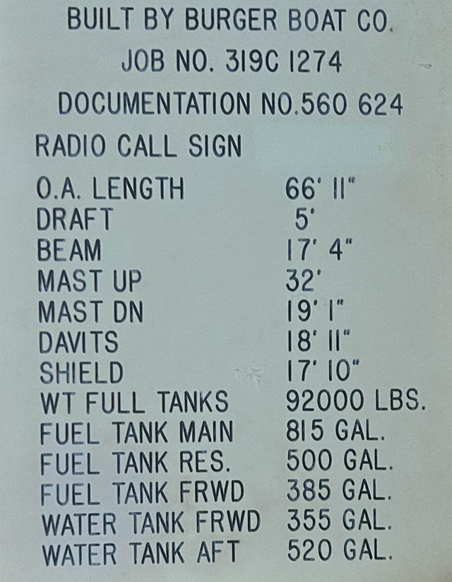

    The tag on the boat shows the Fwd tank as being born a fuel tank.
    She is currently owned by the Save the Sea Turtles Foundation. It sounds like she was just donated to the charity very recently.

    Tag shows a water tank forward as well, and I'd guess that's the forward-most tank under the floor at the bottom of the forward stairs. Perhaps there is another tank in the ER as they aren't listing a black tank, expected to be found between the engines. Most likely the fuel is all found beneath the aft staterooms, and they've simply bulkheaded them for added strength resulting in three tanks where I have two.
    I suppose there is enough room for both a fuel and water tank forward of the ER as the sum of those two "fwd tanks" is slightly more than my water that has room to spare...
    In any event, locate the water tanks for survey, and be sure to open inspection plates there to inspect the inner skin. When she's hauled look at these same locations for weld seams indicative of previous repairs, but the view from inside is going to tell you more than the view from beneath. A water tank will build sediment, and often that contains heavy metals from the water sources. That paste in a dry tank becomes a battery causing pitting that should be visible.
    As she has been donated, likely not getting much useful data from the seller. Burger may be able to send you plans or additional background as a resource, too.
