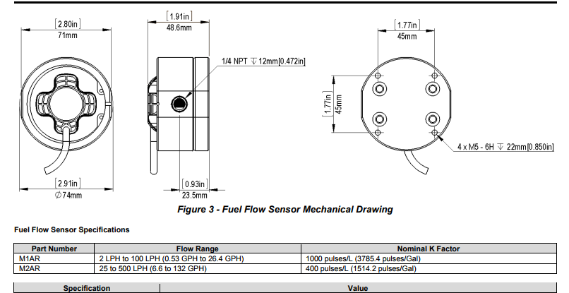

    I'm getting ready to install Maretron Flow meters. My last boat I installed flow scans; which worked well but looking at this technology as something to try as I update my systems. Has anyone added the Maretron flow meters; if so how do you like them and would you please share any install pictures.

    I have the same engines and have been itching to install the maretrons but I have never been able to get maretron to commit to the flow rates those Detroit's use. The sender's I believe have 5/16" orifices while the supply lines are 5/8".. Remember it's not the 30 - 40 gph that the engine consumes , it's the gross flow that they produce.

    I agree with you but the larger M2 meters have minimum range of 6gph. I asked Maretron a couple of years ago if I used those meters could I measure net flow down in the 2-4gph range and they wouldn't provide a definitive answer. They basically won't or can't commit to any design specs.

    That's what I thought I would do as well, until I determined that the Maretron fitting is half the size of the DD engines fuel lines.

    The maretron inlet and outlet fittings are the same size as the engine block.

    Description
    Fuel Flow Sensor - 25-500 LPH/6.6-132 GPHFeatures:Operating Temperature: -40°C to 80°C (-40°F to 176°F)Storage Temperature: -65°C to 170°C (-85°F to 338°F)Port Size: 1/4 NPT FemaleCable Length: 1M (3.28 ft)Maximum Viscosity: 1000 cPsPressure: 68.95 Bar (1000 PSI)Strainer Size: 200 Mesh (If not already installed after fuel filter)/li/ul !--- cis:y4w2Om4GJ5A= ---
    You'll see above that the description for the MR2 has 1/4" npt port size. My 6-71s have 5/8" supplies and 1/2" returns . Based on my knowledge that's a huge restriction point that I couldn't get over. If Maretron is now providing these with bigger ports then that's a game changer for me
