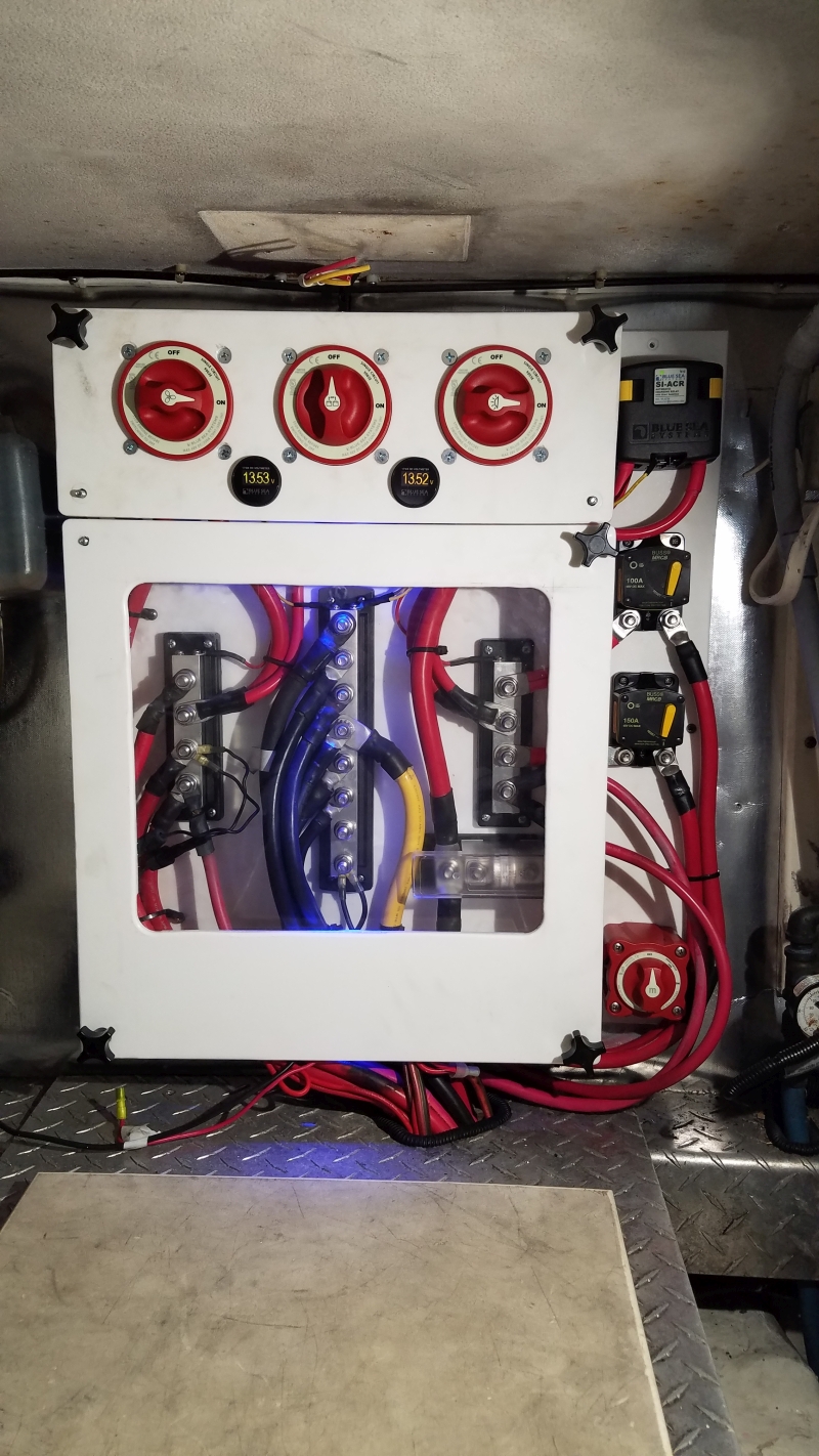

  11. Prospective
    Prospective Senior Member
    Sep 27, 2016
    232
    New England
    I don't know if the solenoids were removed on my boat but on my 2000 43' Ocean there were no master disconnects. Part of the reason fro the major battery compartment rewire I did. There was a small solenoid (not operable) to emergency parallel the start and house banks but no master disconnect. Used to drive me crazy come haul out as I'd have to manually disconnect the battery terminals to prevent the batteries from being drained over the winter. Below is the panel I built and wired two winters ago.
