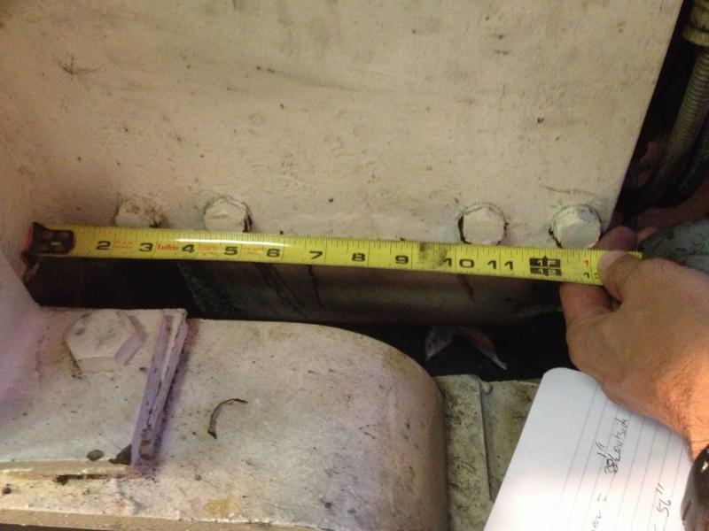

    Hello there everyone!

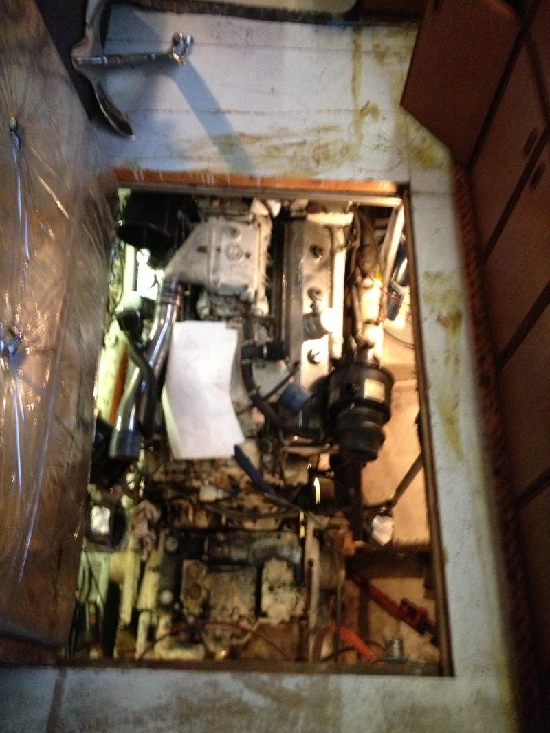

    I was wondering if anyone has ever tried backing off a ZF BW195 from a Detroit Diesel 12V71TI on a vintage Bertram, mid 80's? Mine is an 86.
    The problem I am having is that my flywheel spins freely with a screw driver and does not spin the crank and everything else. I can turn the front of the motor with a pry bar and can see all the cylinders move up and down. Engine did not seize. Anyways, we all know the answer once I back off the tranny.
    What I wanted to know is if it was possible to back it off with out lifting the engine first? The outside Motor mount bracket bolts(pic61) can not be removed unless I lift engine or I am just not see something here.
    Your experiences are welcomed!
    Thanks

    I have a 1984 Bertram 54 with the 12V71TI engines but Twin Disc MG514C gears ... My gears were slid back and overhauled in hull without moving the engine as I recall. I have since stopped fooling around with in-hull overhauls. I don't hesitate to take apart the interior, pull up the nice large panels on the floor and haul the engine or transmission out through the back window. I'll do this from cylinder head on up. Of course, the cylinder head can just come out the back door. Good access leads to better work.

    Thanks for the input. I can slide mine back but would have to disconnect the rear engine mounts and support engine at the rear.
    I am hoping my problem can be solved with out taking down engine, but it has to come out, then My wife is going to start picking out the new interior. LOL

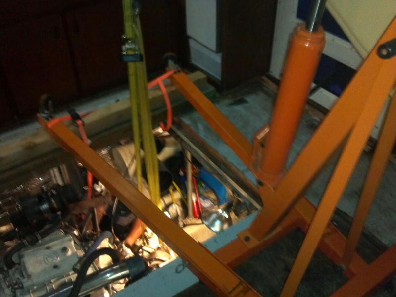

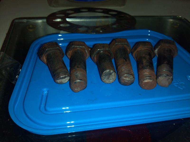

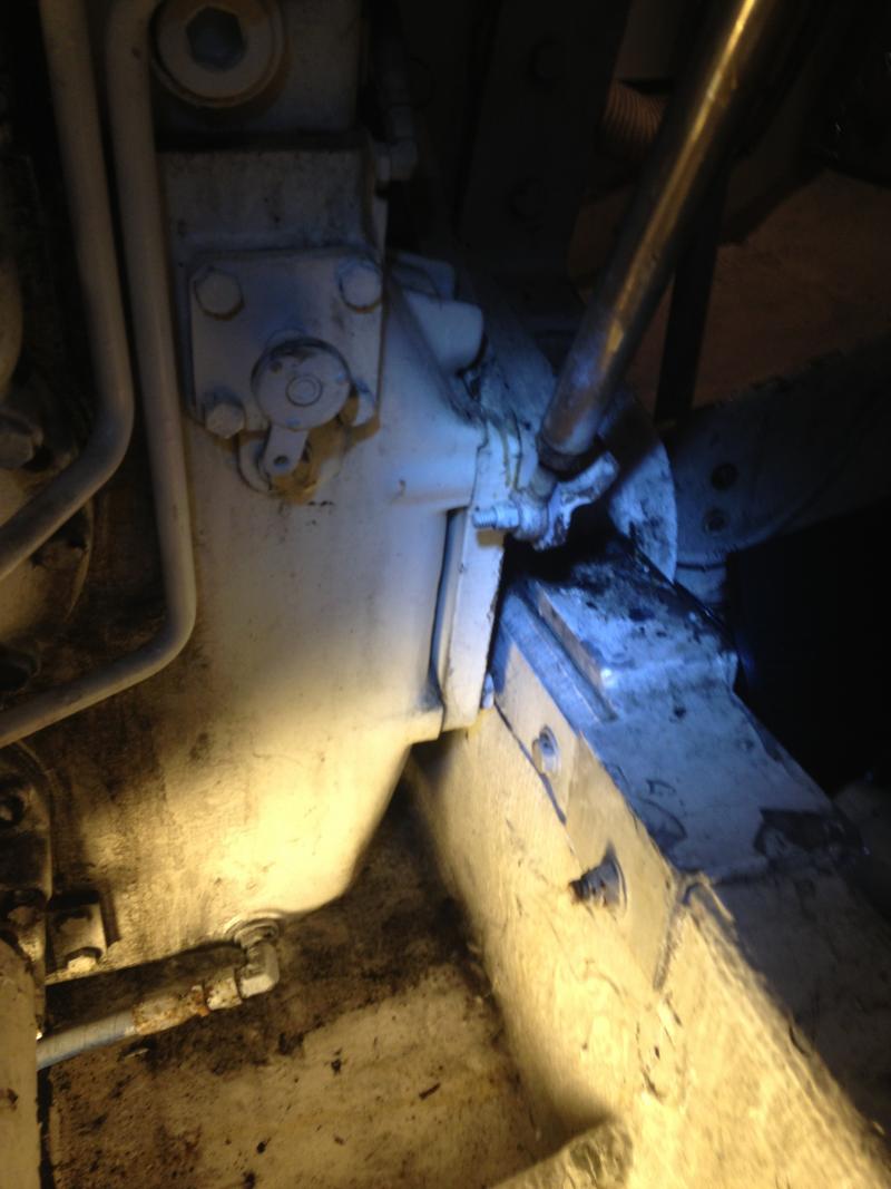

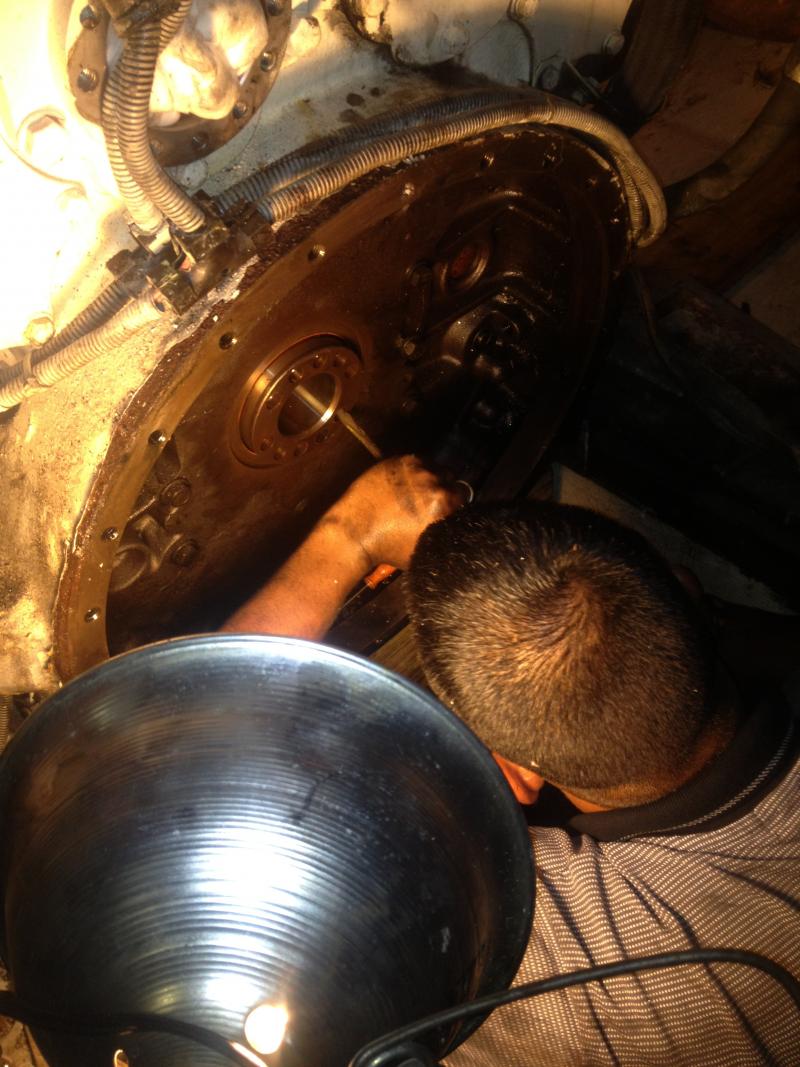

    Okay,

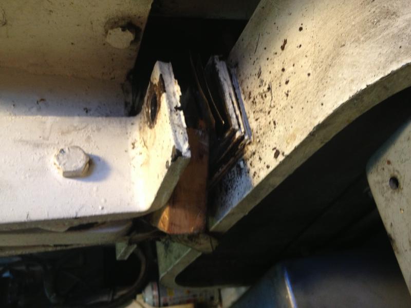

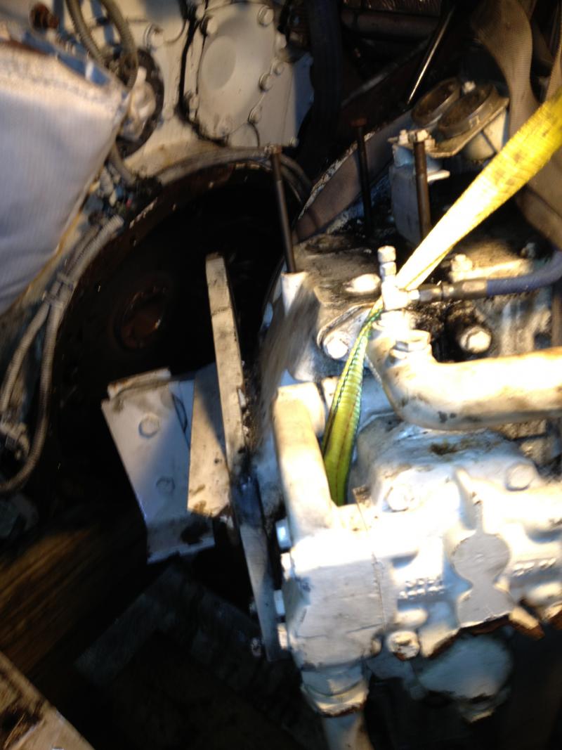

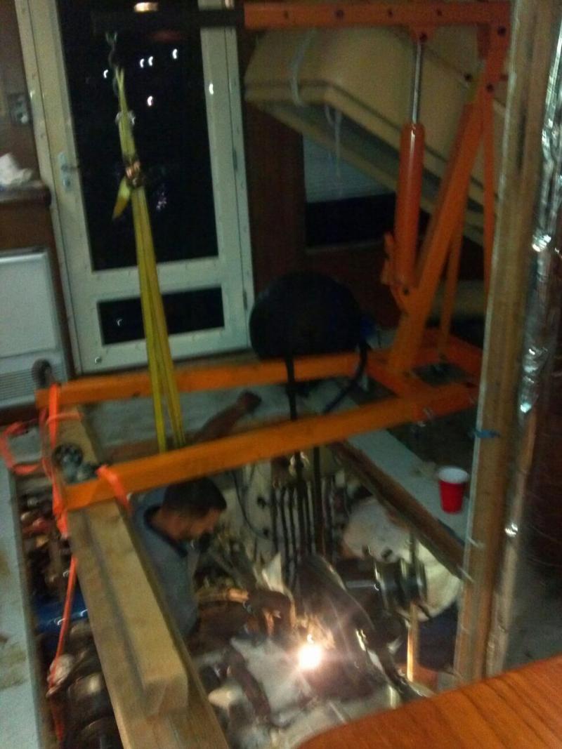

    So here is the scoop. I took down the turbos.. yawn.. I took off exhaust and elbows. I took down Air boxes. Unbolted Coupler and pushed it as far back as it would travel. Unbolted rear mounts. Loosened front mounts. Broke open my Statics text book from my engineering college days and then we tore up the new carpet in salon. Moved furniture around to situate Cherry picker.
    We first raised the engine up as high as it needed to go to unbolt the motor mounts bracket from the flywheel housing side. Then we supported the engine alone on the bottom of the hull at three points. We began to lift tranny until top nuts became stiff, then lowered and pulled them out. We pushed on the top tranny lip with a 30lb chisel like bar. It worked wonders. As the tranny came out we would adjust the height so it would not touch the coupler.

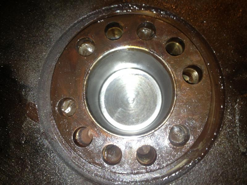

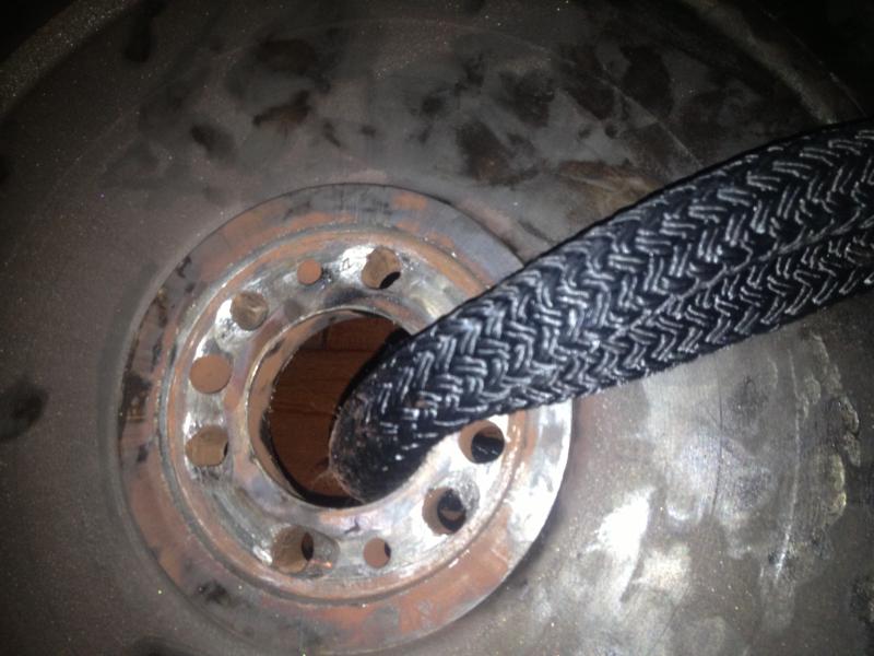

    As soon as we could see the crank, it was GOOD NEWS! Crank end was intact and Bolts had all sheared. 4 of them had sheared a long time ago before I bought the boat. The two I had left went 1000 hrs. We were able to back off some of the sheared bolts already with out extraction tool. Will bring in professionals for final job. There is some wear n tear on the flywheel and we are having a machine shop take a look at it to see if its do able.
    The crank looks pretty solid.. Nothing like 1980's made in the Good Ole USA steel...!!!!

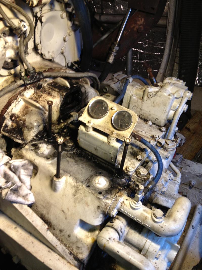

  15. CaptOz
    CaptOz Member
    Apr 13, 2009
    100
    Miami, Fl
    Tranny Removal Pics
    Here are some pics...
  16. CaptOz
    CaptOz Member
    Apr 13, 2009
    100
    Miami, Fl
    More Pics of Tranny removal
    Im sure we have more but this is all I had on my phone.

    That is good news, thank you for posting back the update.
    I wonder if they failed because they were over torqued or had been used as few times and past their best.
    Do all the bolts have similar heads? By this mean are they all genuine hi grade bolts or are there a couple of odd ones in there?
    The foreman I had when I was in involved in the V8 one used to say new bolts are cheap insurance and we used to replace bolts a lot more often than the manuals asked for.
    He used to also encourage us to use new matching bolts and washers on the covers, oil pan etc on the engine when doing a major overhaul, he felt it is something Owners would appreciate and made the engine look neater and tidier.
    It is a trait that has stood me in good stead for many years.
    These days CAT say to use new flywheel bolts every time on the C 18's. I am assuming it will be a similar instruction throughout the range.

  19. CaptOz
    CaptOz Member
    Apr 13, 2009
    100
    Miami, Fl
    Of course all the bolts will be new, since I have ZERO bolts left.. .LOL
    The Flywheel looks like the through bolt holes are too damaged.. lets see what the shop says..
  20. CaptOz
    CaptOz Member
    Apr 13, 2009
    100
    Miami, Fl
    Here are the Bolts.. I just ordered them today from RPM Diesel in Ft. Lauderdale. I should have them tomorrow.
